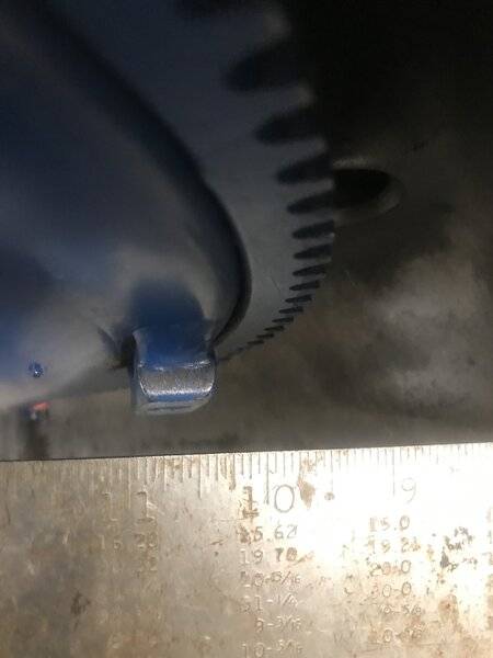

I’m putting my rebuilt 440 engine to my rebuilt 727 and new torque converter. There seems to be no clearance between the flex plate and converter. The converter lugs measure a tight 1/2” recessed from the face of the transmission housing. The flex plate surface is about 1/2” out from the block face. I bolted them together with no difficulty, but pulled them apart after seeing no clearance. Should I ground some off the converter lugs?

Wiggle, push, rotate, won’t go any farther. Here’s what I have.
That looks about right? but the tabs for the bolts do stick out more than I'm used to seeing.
Do you need to flip over the flexplate? is there an offset in it?
Offset on the flex plate is already maximized away from the trans.

I'm not sure there is a problem. The parts are made to bolt up together. Was there interference or pressure when bolting them up? I don't think an improperly seated convertor would let the block mate to the trans without binding up. How much clearance are you needing??
It ended up with there being just enough clearance that the converter and flex plate didn’t rub. All together and moving forward.
If you used the bell bolts to pull it in you had better have the pump inspected. If it went flush to the block on its own you should be ok. When it was bolted up would the converter spin? If not it has to come apart.
