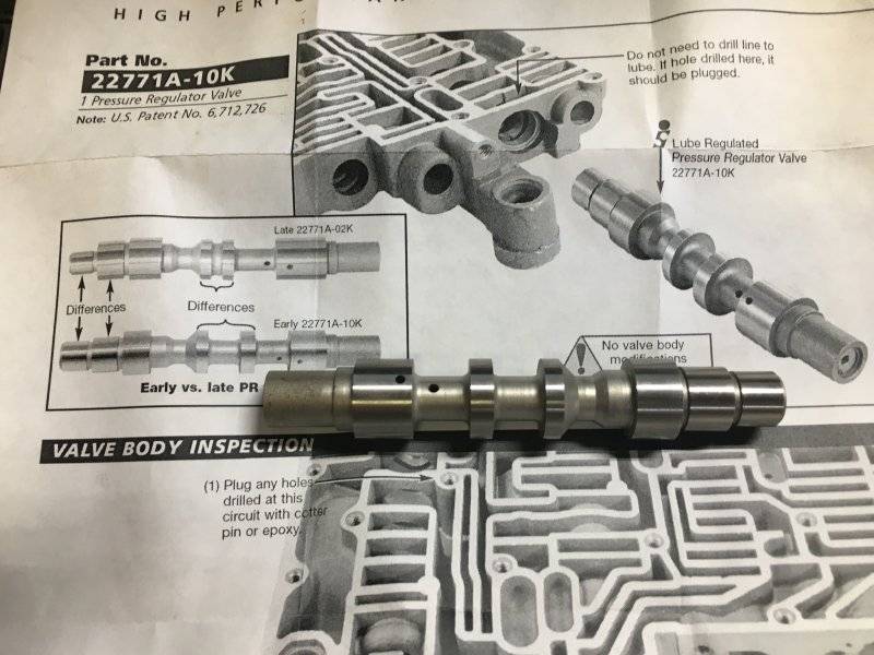

I just went through this 63 PB 727. Sonnax makes a V-body pressure control valve that addresses this issue among others. Mine would leak @ the Park housing and drain enough that car would not move, 3 Qts or so. Have to drop the VB to replace not a big deal. Also while out I drilled the plate in one hole for a better 1-2 shift. The leak is all but fixed but is still seeping from the cable crimp, needs a new cable. Also this trans was rebuilt by who knows who pretty much stock. It needs a better stall convertor A&A makes one for the 19 spline so I am saving to get one about $300.
