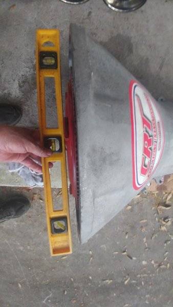

So the plan this weekend was to swap out my tired torqueflight for a brand new unit from John Cope in my 69 RR. I am using the same torque converter that I installed last year after the rebuild of my 440. As you can see from the photos, it is not seating nearly far enough in the trans. There are no distinct "clunks" as the converter seats in the trans. I fought with this for over an hour and could not make any progress.

In fact, I cannot even get it to seat back in the trans it came out of. It is a Hughes 2800 rpm unit. What gives? Is the converter bad? Time for a new one?

It just needs more trial and error if this is the case. Nothings bad, you'll get it. Mopar_3_B's idea is probably the easiest, but look at the ears inside the trans front pump and at the outside edge of the converter for any damage too.
BTW, your fisheye lens is really screwin with my head.
Count the spines. If they are the same, hold moderate pressure against the torque converter not a lot of pressure, while turning. Should drop in when things line up.
Some times it takes LOTS of tries. Look to see where the lugs are to get a starting point. Slide in, pull back slightly, rotate slightly, push again get the first clunk then do it again. The second (full spline engagement) is the tricky one. Pic shows you're not even close to getting the lugs engaged. When you are rotating the converter be sure there's no pressure on the lugs to rotate the along with the converter. Keep trying!
Lift up on the pilot hub. While pushing in gently spin the converter with the other hand.

This morning, I took another shot at it. First, I set the pump lugs to 12 and 6. I set the converter on and it slid all the way into place with, literally, zero effort. Thanks for all the advice. I wish I had done that yesterday...it would have saved a lot of time and even more swearing!
