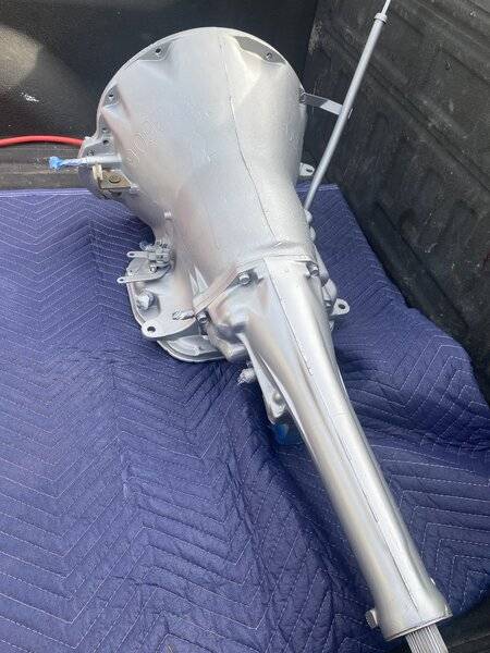

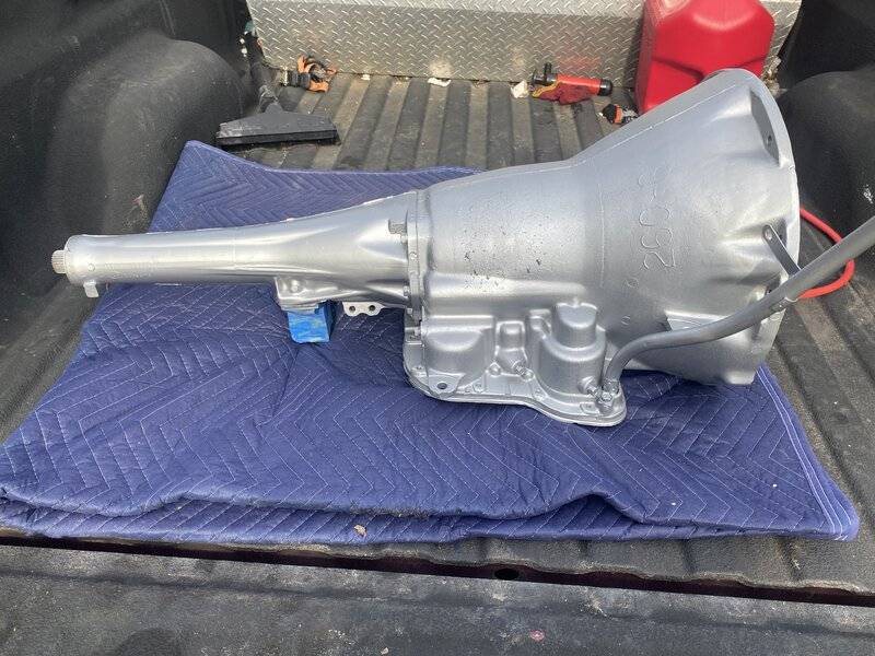

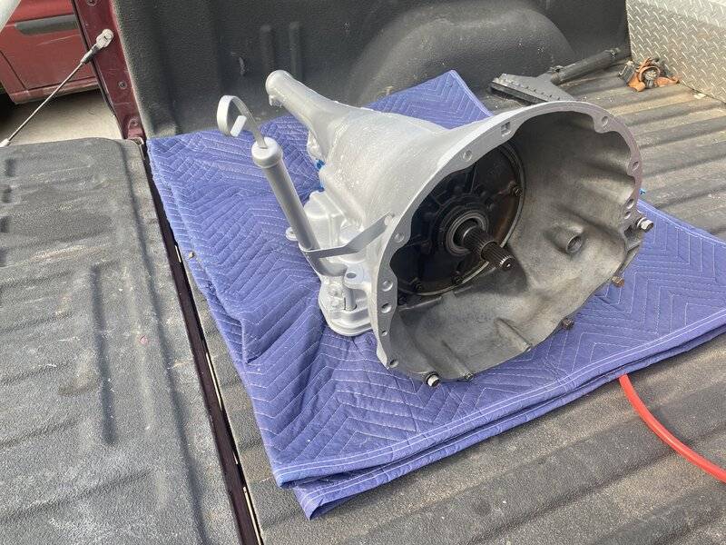

I finally got around to finish cleaning and resealing the 727 tf on my coronet. I bent the flexplate in the process of rebuilding the engine so I purchased a new one along with a torque converter. I installed it earlier today and it all went ok, mainly because I use a proper transmission jack. Right as I was putting my tools away I crept under the car to spin the torque converter and noticed it would rub the bell housing every now and then along the bottom. I followed the service manual when inserting the tc into the transmission and had the 1/2” gap from face off bell housing to tc lugs where the bolts go. From flexplate to torque converter I have a little under 1/4” gap, which means the tc will pull forward to mate with the flexplate. I
Have not bolted the tc to flexplate yet. When I do will that possibly eliminate the slight rubbing of tc along bottom of bell housing?

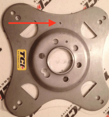

It will... But are you aware the torque convertor only bolts to the flex plate one way..... One bolt hole is offset... If you get it wrong it's easy to cross thread a convertor bolt...
Hopefully your convertor has a drain plug... If it does the drain plug goes 180 degrees opposite the reference hole in the flex plate...

Be sure line up the converter bolts ahead of time to account for the offset lug. When I have it correctly lined up I paint the converter an the flex plate so I can be be sure of the alignment in the future. If you haven't bolted the flex plate tight the converter can drop a bit, maybe enough to rub. Even when tightened there is very little clearance.
Great, thank you for the responses. Yes, my converter has a drain plug and I too saw the service manual shows an image to make sure the small hole in the plate is 180 to the tc drain plug. In anticipation of this when I torqued the flexplate I turned it to have the small hole at the bottom. Later today when I bolt them together I will make sure the tc drain plug is on top or 180 to it. Glad to hear I can finish the installation.
