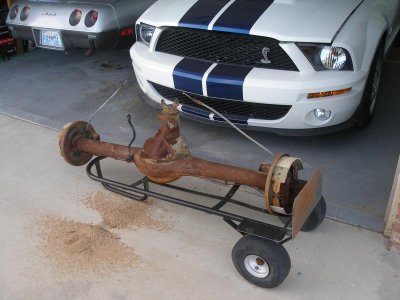

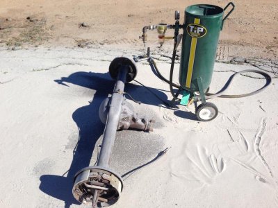

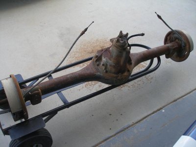

I sure hope a total teardown is in the plans for this rear assembly..it appears that sandblasting of the housing took place without the vent being sealed much less any other points of interest..
Total tear down regardless if it was open, media blasting will push sand right past seals (nasty stuff for bearings).
yes, why I said beside any other points of interest..
many of us know folks that have blasted without regard to ultimate teardown and clean up...and the eventful results of that lack of attention
you mean the rearend he stuck back in already?
ps,to the op,the lubrication qualities of blasting sand have been over rated...
you didnt really put that back in without cleaning it inside did you?

I have no personal knowledge of the final phase of the clean up of this axle, if or if not torn down and if or not stuck back under the car...just throwing out a caution as I have seen many people say yeah I wrapped the ends and such when blasting and forget to cover the vent and other such minor details...in this picture it seems to this viewer that the ends were not even wrapped for protection..as stated by others..that sand gets to places one would never suspect..
yup
It is being 100 percent restored
Going on my 63 Max Wedge Polara Clone
It is a 3:91 from a real 63 Maxie
Yup, being restored....
