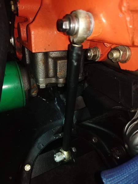

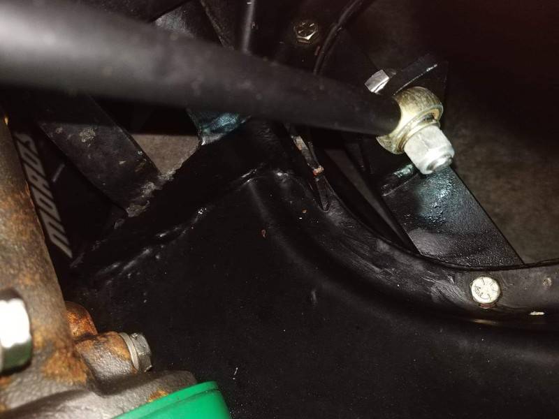

I was reading here about Schumacher closing up recently and a number of people wondering where they could get a torque strap. Might l suggest they make their own. I made mine out of a piece of thick wall tubing, threaded it the size of the Heim joint of your choice. I welded a mounting tab onto a piece of flat stock and drilled a few holes and "Bob's Your Uncle" l bought a mig welder shortly after buying my car and getting some quotes for body work. Let me tell you, that welder has paid for itself many times over.

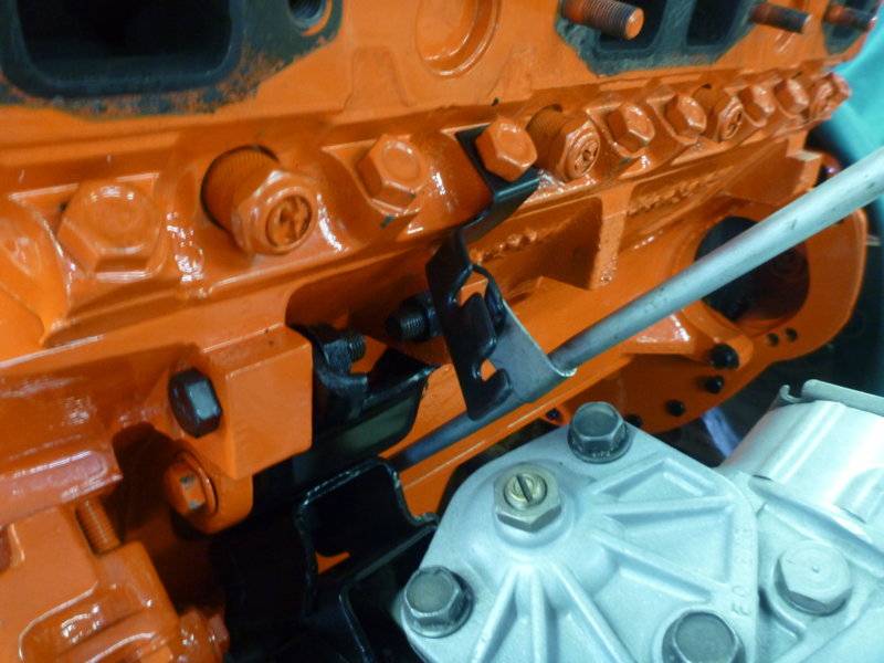

I found a Schumacher on ebay years back. It's actually for a Big Block "E" body. Minor mods and it fits fine.
Yours looks just as good!

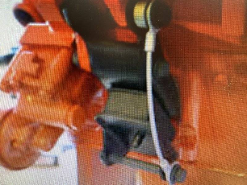

You can occasionally find one of these factory torque straps on eBay. I think I paid $65 for the one I am using.
Had one of those some years back. Don't remember getting rid of it but haven't seen it in years either. Looked a bit on the light side to me to be of any use for something that has a lot of HP though....
I am also running one of the reinforced motor mounts from 440 source. I just thought it looked factory cool. Chrysler used those cable type straps on Police and Taxi applications so the story goes??
