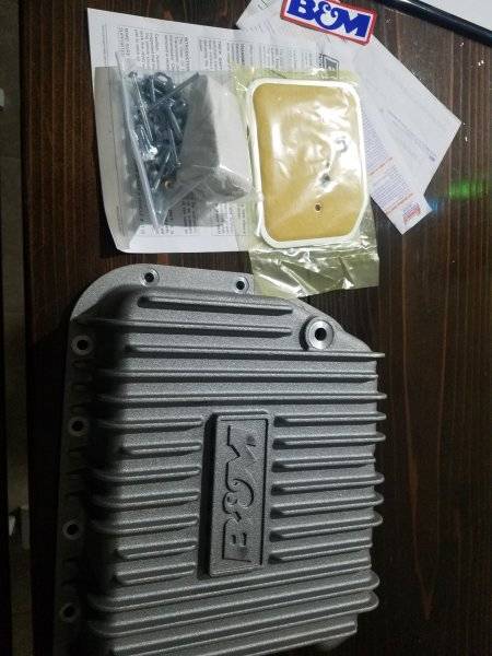

Buy once, cry once. The B&M aluminum pan is nice and seals with cork. Made in the USA as well.

My street car has a B&M. Nice pan but it is HEAVY. And now a days way to costly. The current cost at Summit is $242. The racecar has a R46H stamped pan. Neither one leak a drop.

Just ordered two of those Amazon pans
Looks like it’s 3” deep
Already have the billet aluminum extensions
Cork or silicone o ring gasket
Thanx Scott

The 518 pan works well with the reinforced factory style gasket. My racecar has the same pan gasket afetr 10 years with numerous tear down checks.
