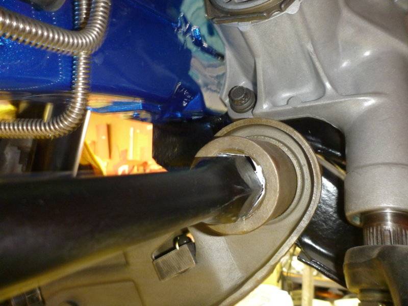

Bump stop NOT in place, bar not engaged at either end yet, adjuster basically all the way out. Slipped right in..

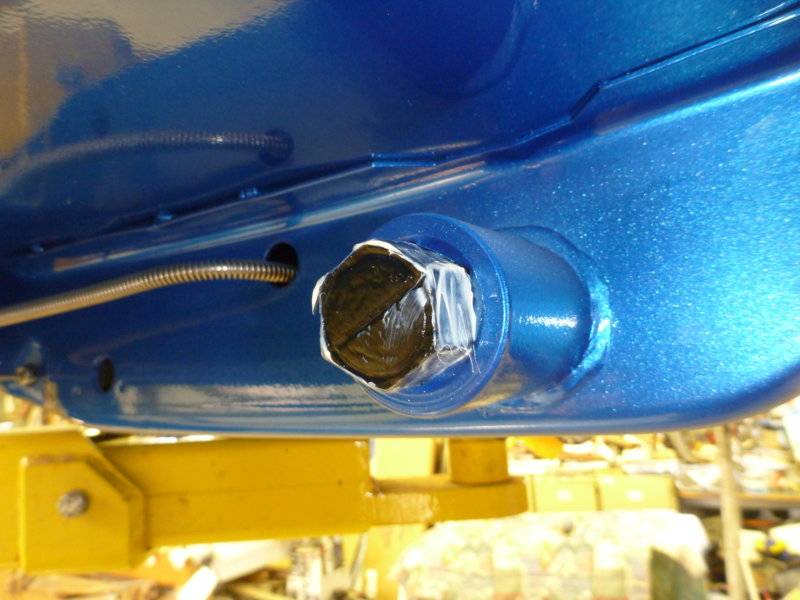

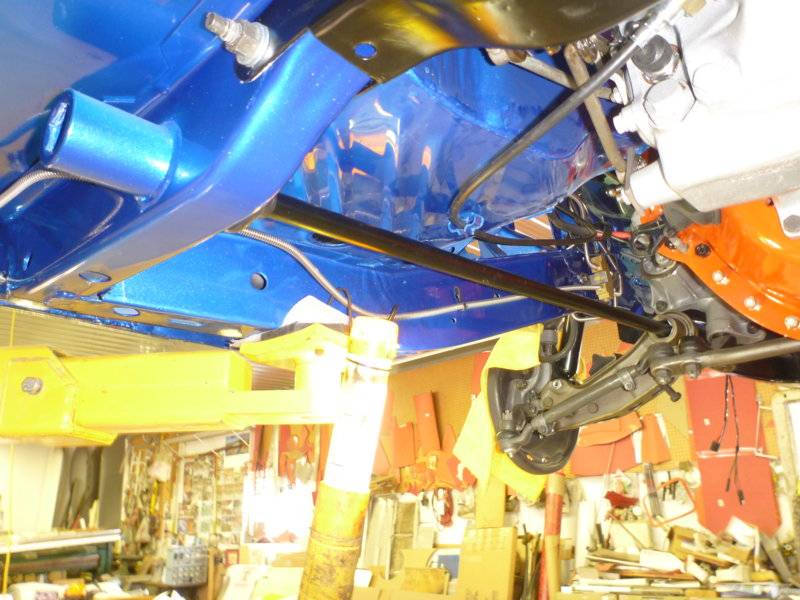

The last pic really helps. Thanks. Mine is just like that and the bar goes in nicely, it’s just that there is no motor or trans in the car and when I tighten the adjuster up just a little bit to remove the slack it’s enough to raise the car off the jack stand supporting the front subframe portion (I currently have the LCA supported by a jack as I don’t have the disc brake spindle in place connecting it to the UCA - just test fitting) and that made me second guess things. I imagine once the big block and 4 speed is in it the adjuster will end up into the recess of the LCA where it should be when proper ride height is set.
Thank you very much, I can carry on Tmr in the AM now..
Expect to put about 20-23 full turns on the adjuster... It may take a little more or a little less but you'll be close...
Yea that bolt usually ends up roughly flush (or close to either direction) with the lower control arm when its done and adjusted close so it'll take quite a few turns to get it there.

Good to know, thanks. With no motor or trans weighing it down now it the adjuster screw is way out and the car sits high... I’ll just get them both in and the car on the ground, get the motor and trans in, then tighten the pivot shaft nuts and strut rod bushing nuts at that time. I’m not putting the motor and trans in from the bottom (lack of equipment to do so) although one day I’d like to experience that. It’s going in through the top, trans attached etc...
@dadsbee - what grease did you use there on the bars?
It's just good old White Grease, anything you have handy will do it's just to stop the bar and socket from rusting together or squeaking! Last reply.. we're off to Alabama !! :thumbsup:
