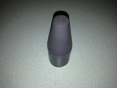

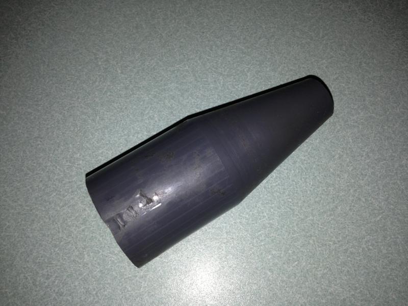

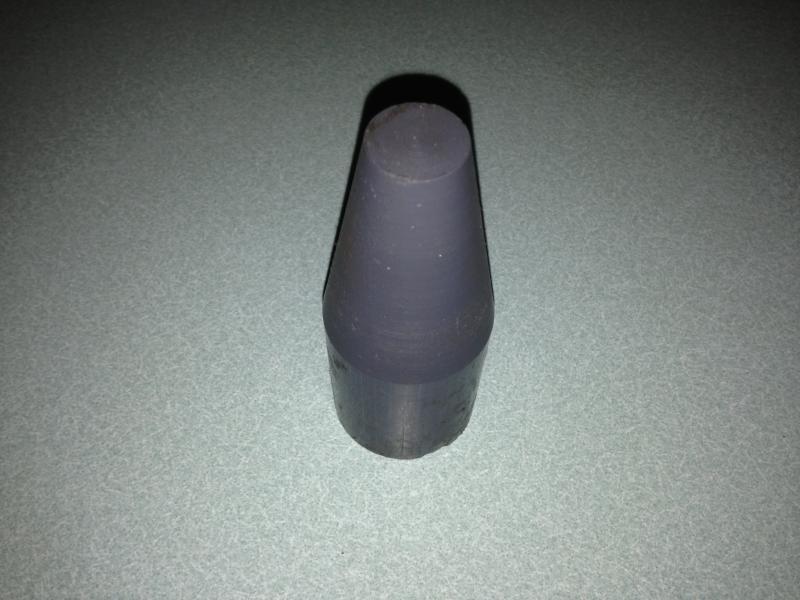

All of the above ...... But we made this cool little tool out of PVC. You could make one out wood or aluminum, steel etc.
Just line it up next to the hex end on the torsion bar and then you slip the seal over the other end. Push the seal towards the bar and your done. Works great .....
