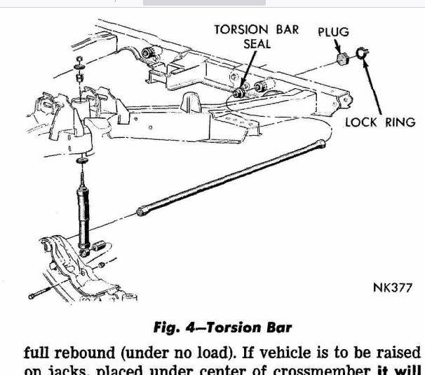

The FM shows a torsion bar plug that goes in before the snap ring at the rear of the bar. I don't see how it would go on my 67 Coronet as the snap ring barely has room to go in there. Or, am I doing it wrong?
Got a picture? I followed my fsm when installing mine and iirc it only called for the snap ring
If the bars are inserted all the way, you are good to go. I have never seen a plug in that location. My shop manual does not mention it in the text, and my 67 parts manual does not show or list it. It's only purpose would be to prevent corrosion in the socket.
I recently replaced torsion bars on my 66 Charger. Not sure what the "plug" is you refer to. I you have had them out, or replaced em, you need to tap on the end of the bar to properly bottom them out into the hex socket in the lower ctl arms. You should have plenty of room between snap ring and end of bar if you do that. Just grease up the ends of the bars when installing.
Pulled a lot of bars out of cars over the years and have never seen any plugs back there.....
it was on a image pulled from the net that said it was from the 67 Coronet FM. Had a plug and then the snap ring. I didn't remember a plug. I have since looked in the service manual and there is no plug. So, I guess i'm good as my bars are bottomed out in the LCA's and the snap rings fit. I will do as suggested below and grease the socket up around the rings.

None on my 66 and I know they were never pulled. Here's from 67 FSM.
