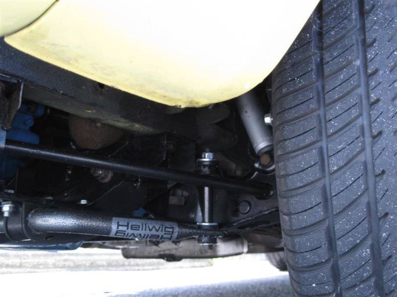

When I did my 72 Charger and 71 Road Runner I went with MP .96 bars and a Helwig 1-1/4" Big improvement and what I saved using the MP bars bought the sway bar.
I was leaning to the MP .96 bars also. Are they made in USA ?
