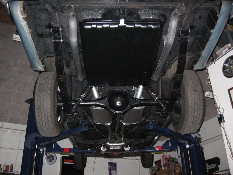

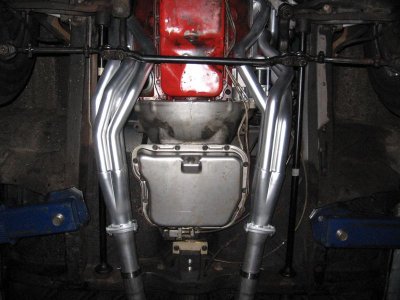

You will be very suprised what adding a 4 barrel will do for a poly.Really wakes it up. I did it to my 64 Belvedere.Enclosed are a few pictures.
FYI, I had a 500'' big block all ready to go in this car but the poly ran so good I never did the swap.
That new intake from Hot Heads is well worth the money.I used a Weiand intake that I bought years ago when they were still on the market.A 600 Edelbrock AFB went on top.
The car also has TTI headers and exhaust.Like a dummy I sold the car, a big regret. The only other thing I was going to do was valve seals and new valve springs.The engine was low miles but 50 years old.Even with a stock cam wow did it run !
If yours runs good you might want to stick with it. Just something to think about.....

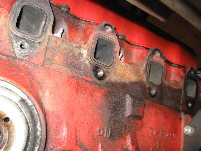

Other good points about a poly,Full floating wrist pins(like a 340) solid lifter cam, and I think (though it has been debated) that the heads breath pretty good. I know I'm goofy but look at the photo, , Can you say HEMI?

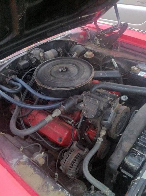

& here is old faithful hah.

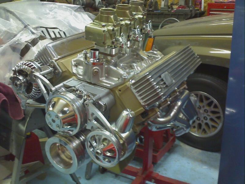

Moparcrazy I wouldn't trade my poly for two of your common as fleas on a hound dog 440s. To each his own.
