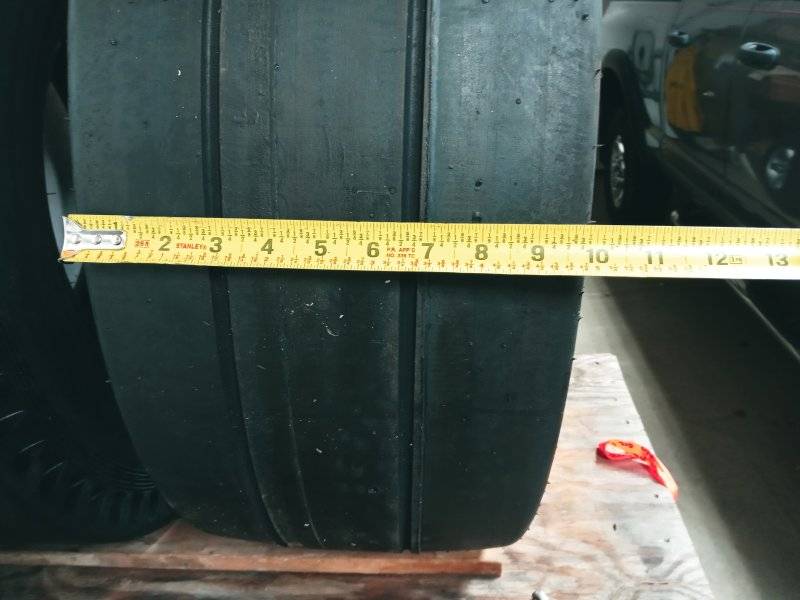

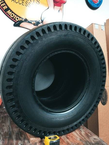

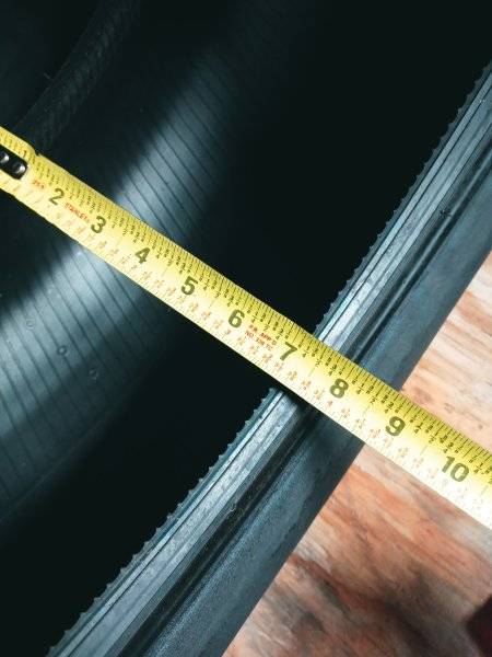

We're running both the Towel city and Firestone repros in 10", the T.C's section width is no wider than the tread and easily fits in a stock '65 Coronet tub, I don't know what size tire or brand they used because it's shaved smooth, the Firestones are wider than the tread and require some extra height to fit, both have torque thrust, 8" iirc
Towel City

Firestone's
Towel City
Firestone's
Thanks for the info this is exactly what I need to know I want the height also my drag radials are 28 and I’d like a 30 or at least a 29
