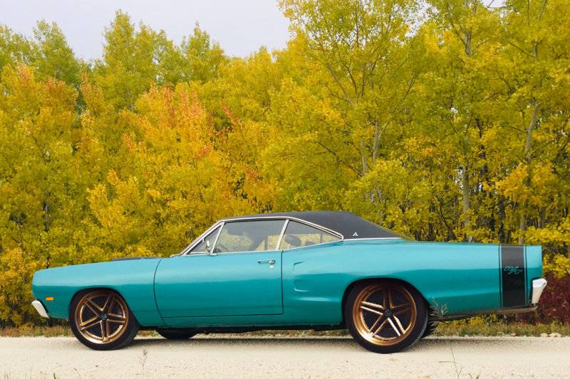

I'm considering upgrading the brakes and wheels to something more substantial and after doing a little handywork on photoshop, I think I found what I like.
What do you guys think?
