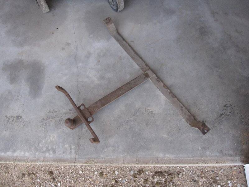

Does anyone have any type of drawings or pictures of a trailer hitch setup for 68-70 Charger? I need to either make or find one so I can tow a small trailer on Hot Rod Drag Week. I'm trying to figure out what the best way to mount one is since it's a little difficult with the tail pipes and fuel tank kind of in the way.
This is a photo of a Draw Tite hitch for a 1971 Charger.

So I ended up acquiring one from another member here. I’ve been looking at it under the car and can see how it mounts to the frame rail but the plate that’s on it near the ball, there is no way it will mount anywhere so I’m trying to figure how to modify it so it will work.

That rear plate bolts to the bumper unerneith the license plate.

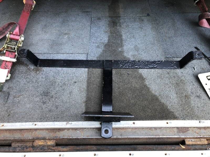

I have one on a 67 coronet i just bought, I’m heading there tomorrow ill take pictures?
