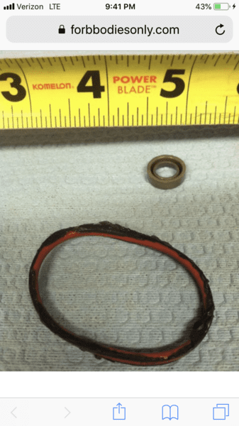

I think I have a good leak at times around the metal nut of the speedo cable. I know there’s a large o ring that goes around the adaptor. But, I believe there’s supposed to be a very small black seal that either goes inside the metal nut or over top of the adaptor threaded portion. I believe that’s causing a majority of my leak. Because I didn’t find one. It’s only damp around the big nut and metal jacket of the cable. Does anyone have a picture of how and where that little seal is installed ?
I found this picture Googling. The little seal. Where and which direction is it installed. I’m assuming, if you remove adaptor. It’s on the inside, end of adaptor that is actually on the inside of tail housing. Can someone confirm this or better yet. Show a picture of the little seal installed ?
I found answer. It goes inside adaptor stem. Exterior portion of adaptor.
Looks just like the selector seal
Thank you, I assume selector seal is slightly larger. When you install the adaptor seal. I think the spring faces up ? Not sure ? White the selector seal, I think the inner spring is the opposite and faces down ?
