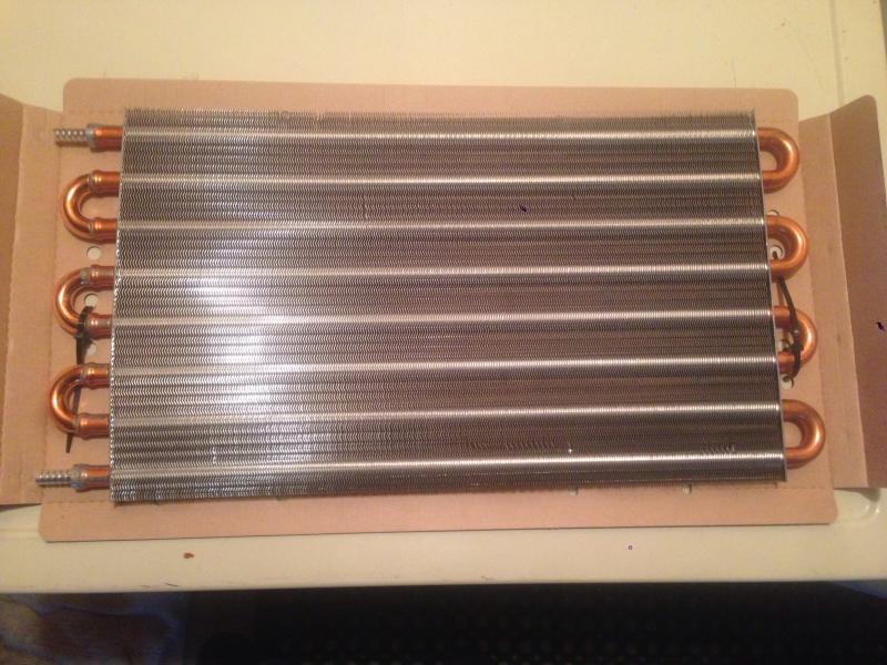

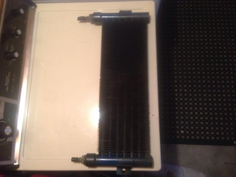

Here is my old heavy steel cooler. 19.5"x7"x2" with 2 rows 7 tubes each row, 1/4" tubes
Below it is the new flex lite I first ordered. 17x10x3/4 with 8 tubes 1 row 1/2" diam tubes. image.jpgimage.jpg
Weighs ten times less than old cooler but no brackets included.

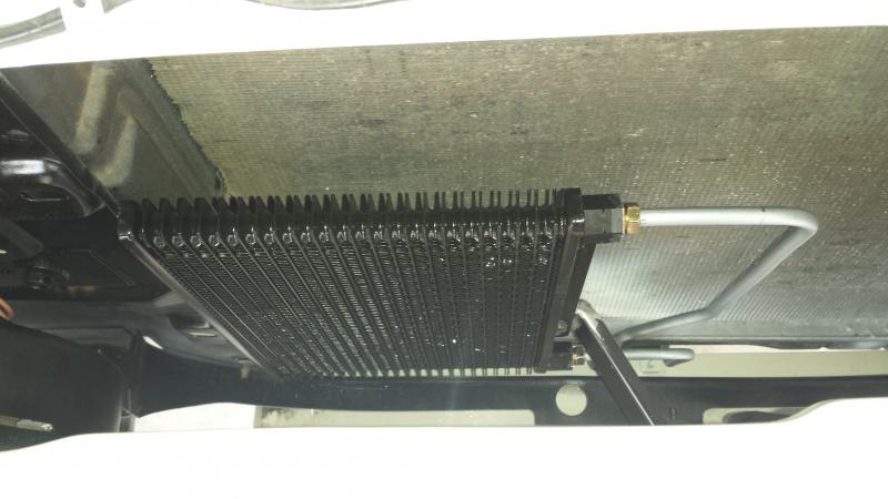

Here are a few shots of it installed. 1962 Belvedere. I ran the pressure line to the radiator cooler, out to the top of the trans cooler, and bottom line of trans cooler to return port in transmission.
Pass side is mounted with 2 flush head bolts ( I would have welded threaded studs but engine bay was already painted) and I fabbed the other mount from a spare battery tray bracket. Nothing drilled in front, used existing bolt hole.

that's slick! I like how you mounted it off to one side to minimize radiator flow interference and also that you used a left over battery tray support (I have 2 of those as well!) with no drilled holes. Thanks for the idea.
No prob. The cooler has full length mounting tabs on both sides. The pass side tab is wedged between the radiator support and the radiator. Mounted with thin head bolt and nut through the support. It is very sturdy.

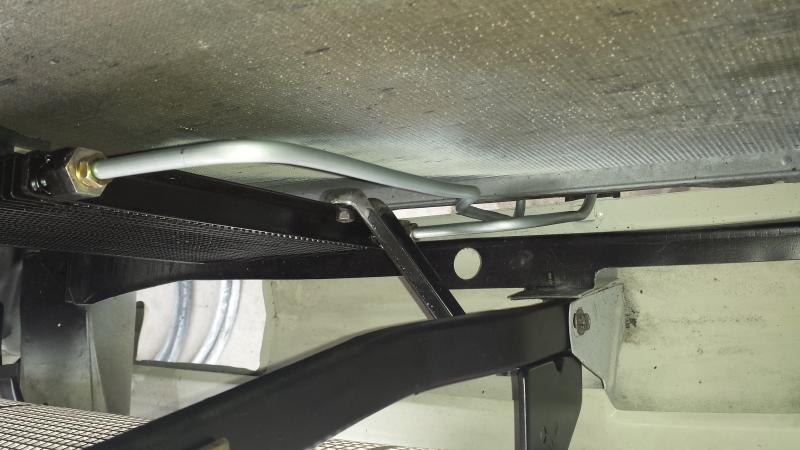

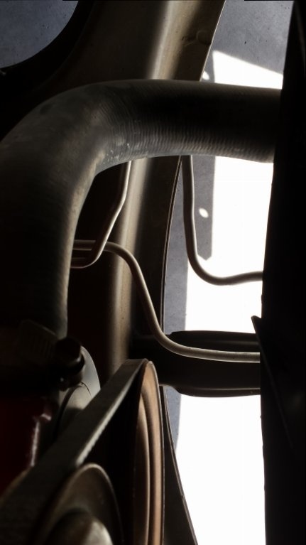

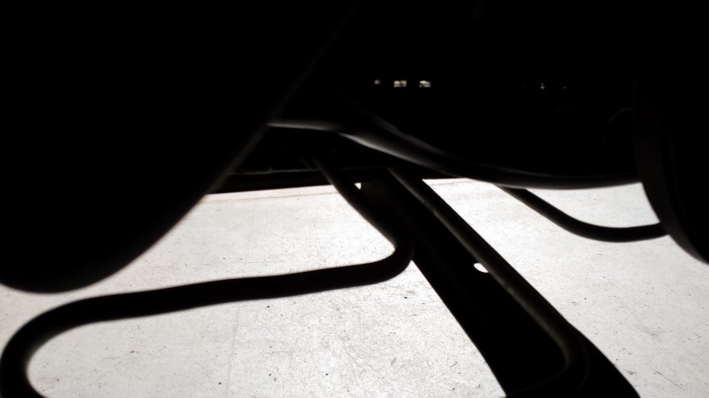

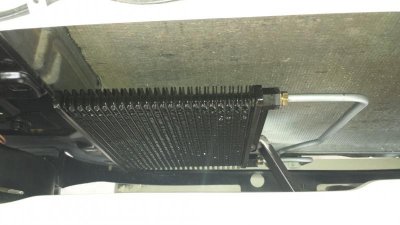

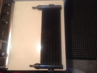

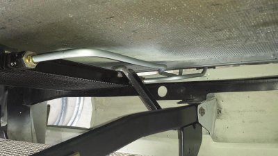

Ski, here are some pics since I cannot get them to send via conversation. ..
