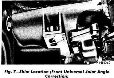

Are there supposed to be a shim or shims on transmission (727) mount? Thanks in advance.
There can be. Maybe some one was adjusting pinion angle and could not get it right with the rear axle alone.
I have a 3/32 shim in mine.
