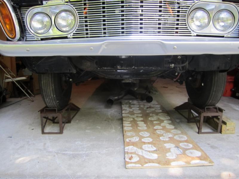

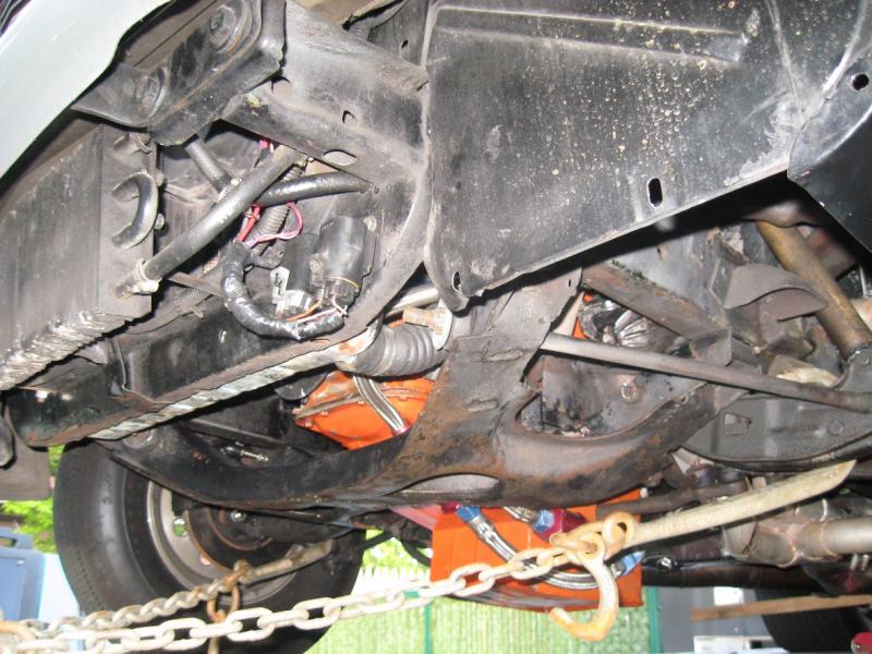

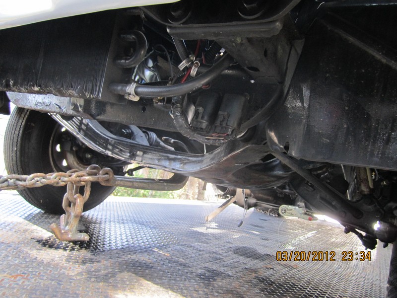

Here's a few in my archives that show the cooler:icon_eyes:Next time I'm down at the garage I will take some pic's for ya:blob1:
