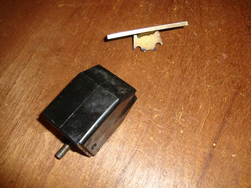

ENERGY SUSPENSION 51112G Transmission Mount Performance Polyurethane
Did it break the flat plate that mounts to transmission off?
It broke the plate that is embedded in the polyurethane.
Heard a ticking noise every now and then, couldn't figure out what it was, was 800 miles from home when it happened, drove it home like that.
I carry a spare rubber mount on longer trips now.
