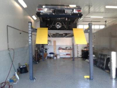

Thanks everyone. I have done this before, just not on this car. I have 4 post drive on and trany jack. The headers are Tti 2 inch step. Just thought I would ask and see if anybody had tried. Thanks again
