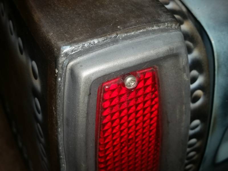

Painted the rear aluminum light borders on my 66 with the stuff - they still look great after a year of this NC weather ( especially the Summer sun and heat )

Here's a pic of the part on the car . . . this is the matte finish . . .

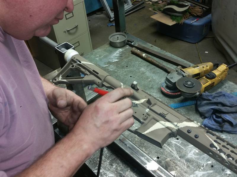

Found this picture to show the process . . . here's my friend trying his hand at Cerakote on an AR-15 . . .
Agree, saw the Cerakote word & immediately thought-GUNS!!!!
