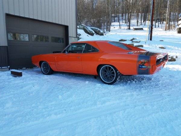

To answer questions regarding stance, tire size, ect... here it is.
