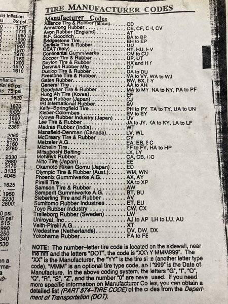

Well I’d bet the M/T doesn’t manufacture their own tires. If you can get a manufacturer code you’d be one step closer to learning more.
This chart years ago told me some $30 pep-boys tires were made by Michelin.
Not even their website shows it. I would imagine it would depend on the tire size, also. And tbere are different applications. I would contact Goodyear/MT.
Mickey thompson is a cooper tire company. Did goodyear buy cooper?
