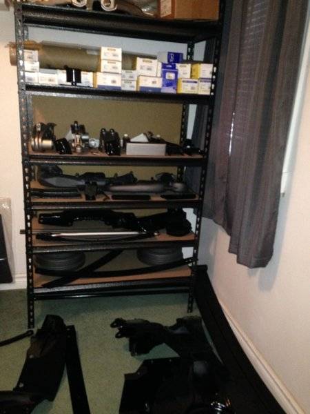

Here's a picture of some of my "DONE" parts in my sons old room. He's not moving back in any time soon. lol
