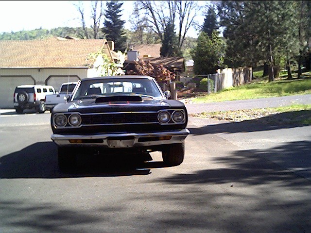

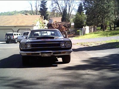

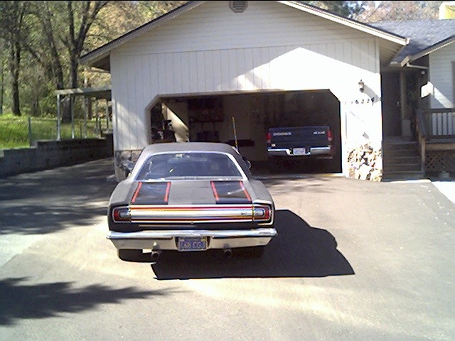

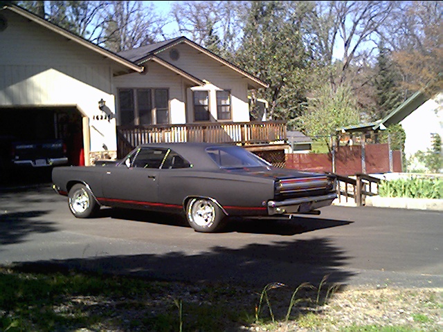

It will take a 13" wide in girth & 29" tall tire with out alteration or lowering, allot depends on the rim back spacing too... I have 295/50/15's easily under my current 68 RR on the back w/15"x9" rims & 5"B/S & 245/60/15's up front w 15"x7" & 4.25" B/S, no relocation & no rubbing issues at all, front or rear... if you go to a 10" wide or wider wheel/rim in the rear a 5.5"-6" B/S will be required or move the rear leaf springs or go to a different type rear suspension, depending on tire girth/width & height/body stance {ride height} whether it's lowered or not & I highly recommend you purchase a Percy's Tire Fitment Tool, from Summit racing or Jegs for like $70, you can figure out exactly with the fitment too, what exact rim diameter & what height & widths of tires will work with a specific ride height or rim backspacing etc... the tubs/wheel wells get narrower as you lower the car... I hope that this helps some there are a ton of these type threads in the general discussion forum section... sorry the photos don't show the tire size very well the rear is lowered 1-1/2" the front will be lowered 2" More inches, when the new suspension parts & brakes are installed also... wheels are Halibrands Polished Kidney Slots & BFG radial T/A's

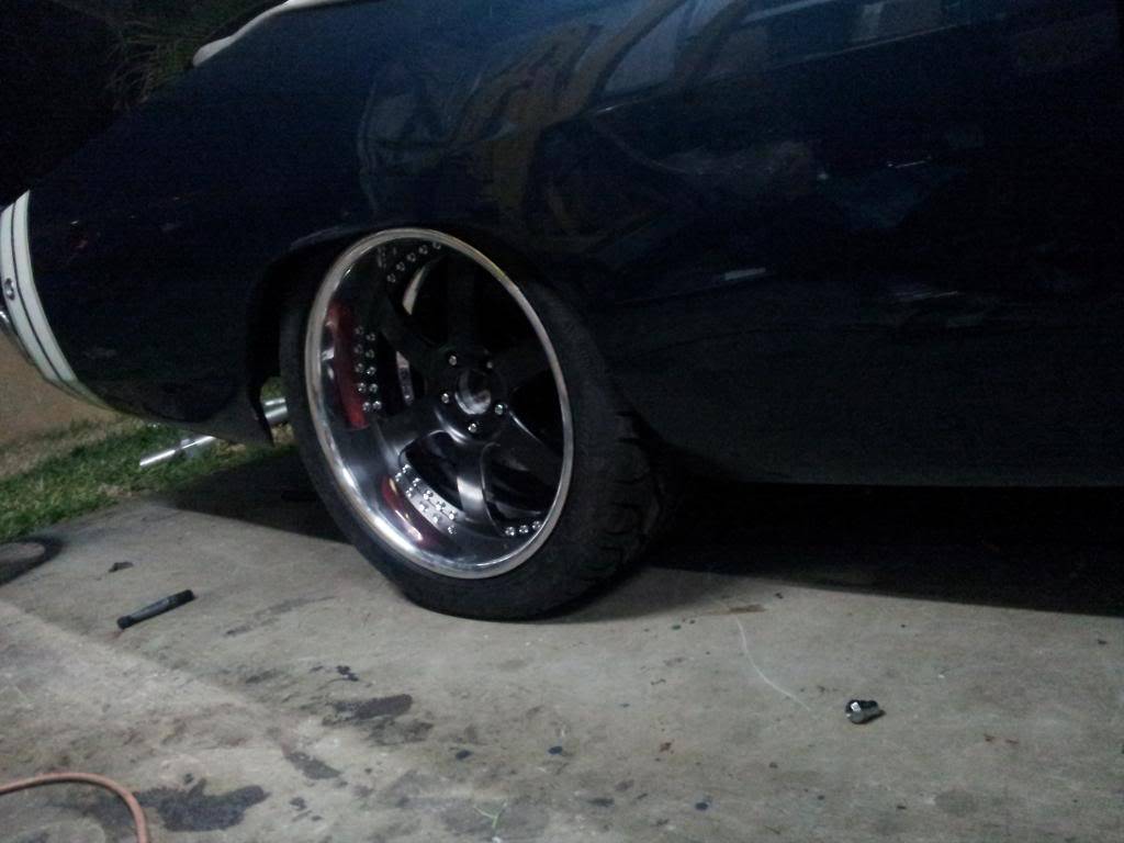

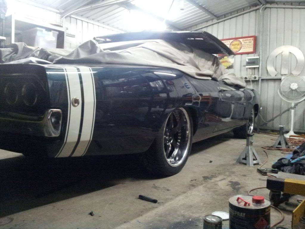

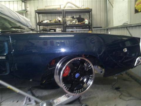

well i tried to upload pics of mine in first post but no luck but here you go ,19 x 10, 295 35 19 fronts 18 x 8 245 40 18
Man that looks good Benno. Love the color. Like I said earlier, done correctly, I understand the apeal of the 19s & 20s. Do you know how tall your 295/35 19s are and the section width?
Does anybody know if the rear wheel well is designed differently on the Chargers than it is on the Birds? I know that Chargers have several other subtle design changes but not sure if this is one of them.
thats a 27" wheel/tire. section width ? is that sidewall? if so mine is 103 mm
chargers and birds of same year are identical wheel walls i have been told
Thanks, yes section width is sidewall to sidewall. Should be the widest portion of the tire. I know you can figure it out by the actual tire size but it always differs a little once they're mounted. A narrower rim can make them bulge, a wider rim will flatten the sidewalls out some.
