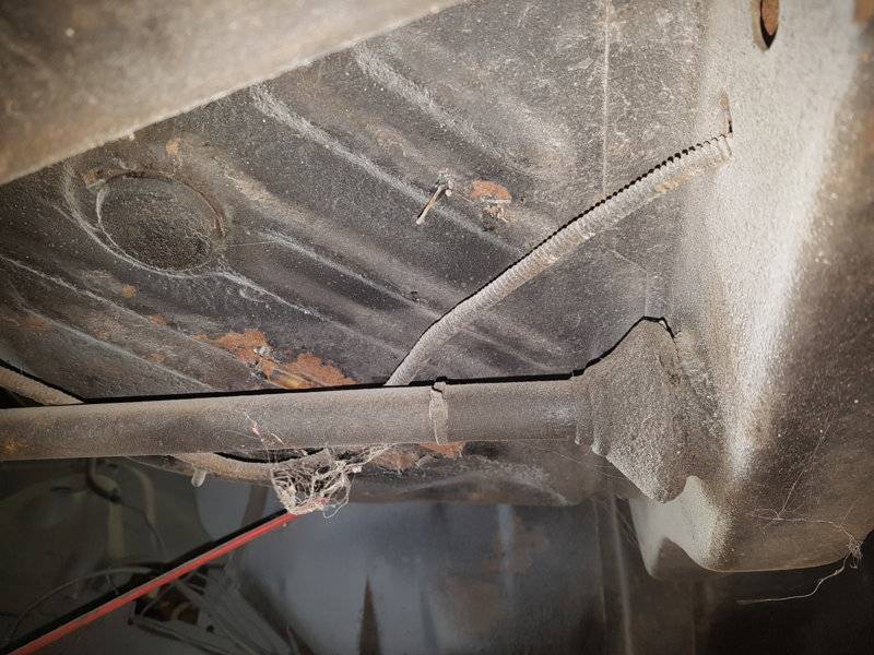

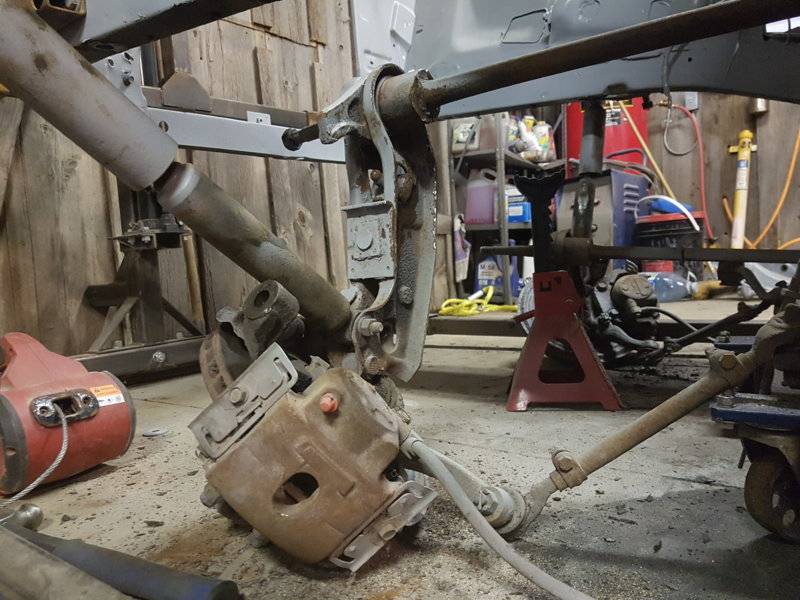

I'm trying to remove the K member and all the front end steering components and suspension in order to put my car on a rotisserie. I got the one torsion bar out of the car but the other one does not want to move. I have tried smacking the lower control arm forward to get it to come out like I did the other side but it doesn't seem to be moving at all. Does anyone know what tricks will work to get this thing out? I did a bunch of searching but all I found was people trying to remove it from the lower control arm.

At this point, about all I can think of is to hit the lca forward off the torsion bar.

I followed your advice, I have it supported and I've been using a socket inside the hole but I can't get it to move any further. It looks like it has already moved almost a quarter of an inch from my earlier attempt, but it won't budge any further

Just looks like BFH time to me. Knock the LCA off and then you'll have an exposed bar to pound the other way.
Do you have a jack all? Should be long enough to put it against the cross member and "jack" the LCA off if the BFH doesn't work.

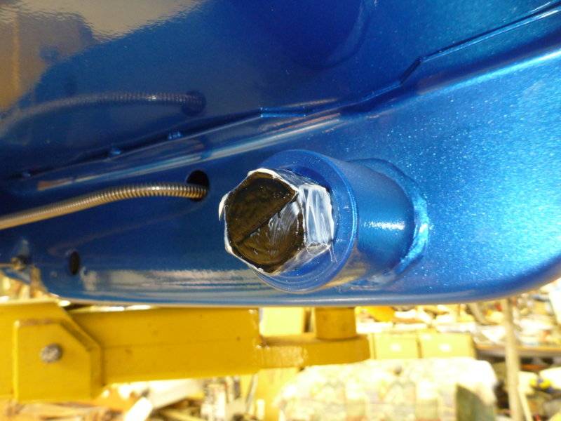

The bars are designed to be removed via the rear of the cross member WITHOUT removing the K frame or the LCA for that matter. The bar is simply "sitting" in the LCA socket.

It should come out from the rear. You nay have to remove the rubber bump stop to get full travel on the LCA to allow the spring tension on the torsion bar to completely relax. Unless this is such a rusty piece, it should not be this difficult, provided you follow the advice as given above. :)

Tap your control arm forward and remove it from the torsion bar. Then tap your torsion bar back and out the rear. It does not matter which way they go. They are designed to be able to be replaced with the car full assembled. Meaning out the back. But the front is fine if the car is apart. The socket is continuous right though.

No, it is a "through" hex, but it is supposed to be removed out the rear. If the current one is stuck, the LCA should knock off easy and then thump the bar out the back!
