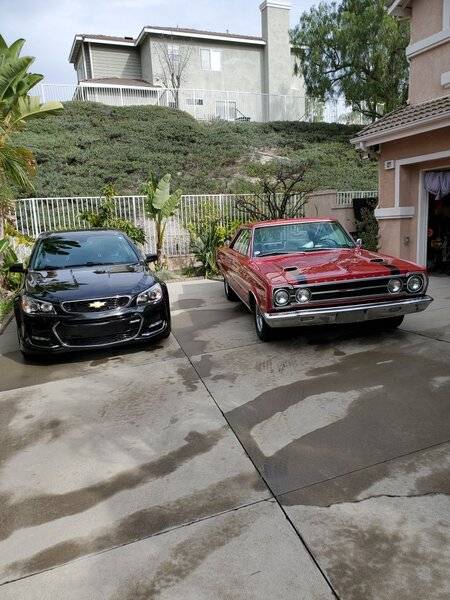

Nice GTX.

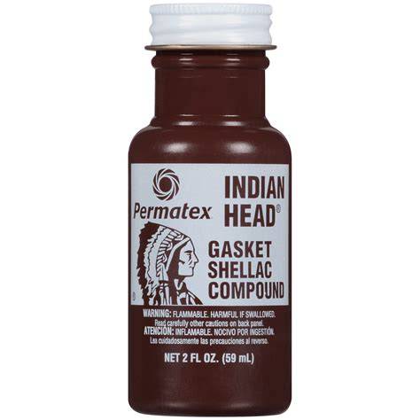

RTV is the wrong sealer for that. Try Indian head gasket compound by permatex. Put a coat on the hose and the housing wait for it to get tacky and install. Let dry before putting in the coolant.

Also, I'll second the Indian Head shellac that R413 mentioned. You can get it just about anywhere that carries permatex products. If the hose is correct, it will seal up.
I would NOT use RTV.
