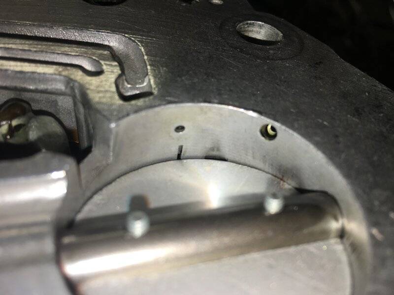

4.5 turns out is too many. The screws should function in the 2.5-3.5 range in a Quadrajet. Are the transfer slots exposed at curb idle? They shouldn't be visible. That would explain why there is little effect turning the mixture screws. Perhaps some dirt is blocking the idle pickup tubes? Those tubes do fall out of the casting quite often. Have you had the carb apart yet?

I dont know much about carbs but im assuming the transfer slots are the horizontal ones? If so, they appear to just barely be visible. I havent had the carb apart yet, but i still find it strange that the problem doesnt go away when swapping carbs.
those butterfly's are open to much. The slot should not be exposes that much , if at all.
As mentioned that's why your idle screws are having no effect .
If you can't get the car to idle by adjusting the main butterfly, you can adjust the secondaries slightly to get the air you need .
