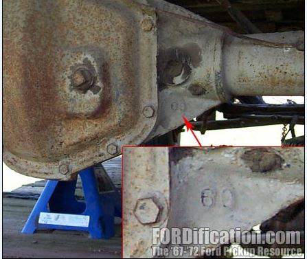

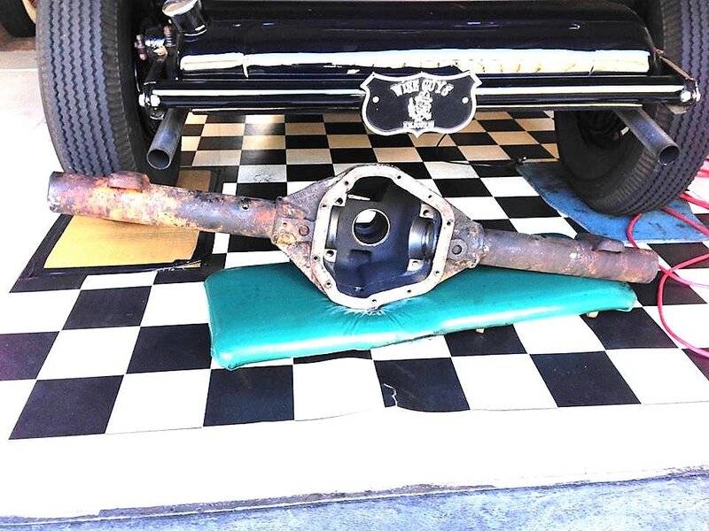

If it says "60" like in the pic its it's 60. My car and my sons Turbo car both have Dana 60's that started out as 8 lug. Torch the brackets off. Put a 9" cut off wheel (Lowes / Home Depot) in a miter saw. You'll need to shim the tube up on the saw base with wood so the tube sets square on the table. Leave the tubes as long as possible. There isn't a lot of length left for the long tube (pinion offset). Once the ends are cut off you can set the tube on the saw without the wood to make the final cut. It cuts square and clean. Just take your time. My sons car we measured the back lash before disassembly. It was .007". Just added a spool, ends, axles. Never even pulled the pinion. Cars been 9.55 on the original R&P.

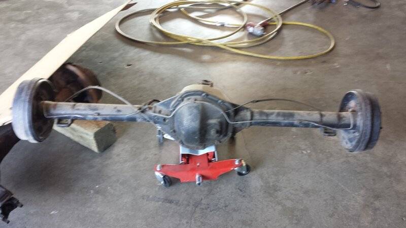

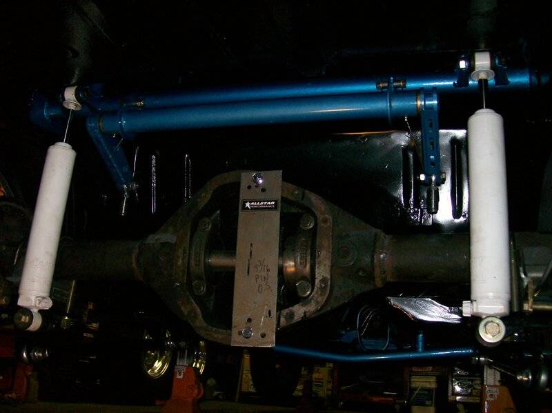

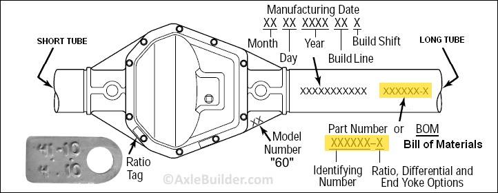

Thanks for that. It will help alot. Just wondering, it shows the long tube on the right. I thought Mopars had the right side shorter??
Right side with the rear in the vehicle looking at the rear from behind.
