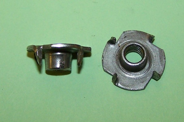

But yes, the fold down section is simply plywood which can be cut from 1/2 inch plywood as I have one sitting in may garage right now. The carpet is glued to it and it has the chrome edge surrounding it simply screwed on. The attatching screw holes for the hinge are simply Tee Nuts that I got a Lowes. (Pictured)
Not much else to it.View attachment 141178
