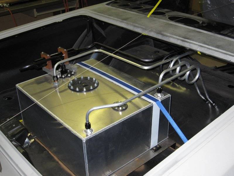

On the brackets welded to the fender wells a series of adjusting slots are located to vary the spring preload. ease the bars down to relieve the tension and they will come out. I had a little trouble when I removed my springs in 2009. Then I fabricated new fuel and vent lines without leaving any clearance for the springs so, I installed struts instead. Be careful!

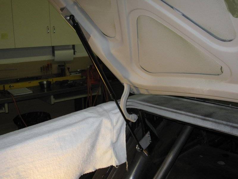

Struts that I used: NAPA 819-5538
Mounting hardware: NAPA 4 each: 735-1896
NAPA 4 each: 735-1990
These struts worked with my leverage points. Yours may be different but, that's up to you.
I used a board to hold my deck lid up as I work alone most of the time.
Mike

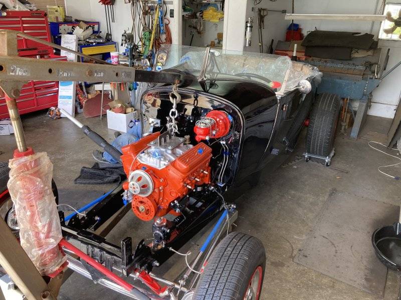

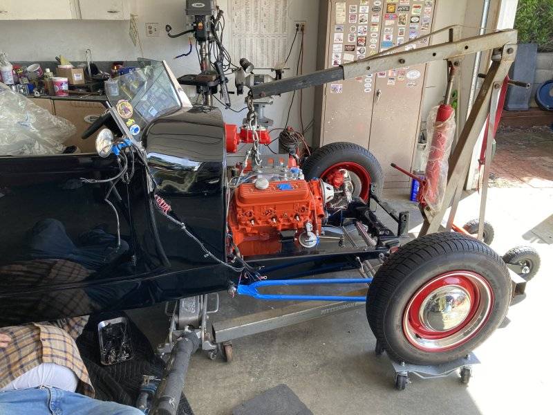

Engine/trans is in the 32. I've known this guy for many years, was a customer of the speed shop I worked at. Hot Rod guy who did HVAC sheetmetal for a living before he retired. He has a stomp shear and some other stuff I don't have and vice versa, so I help him out when he needs a hand. Good to have connections.
