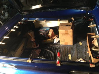

Got this done last night. Took my time, came out nice.

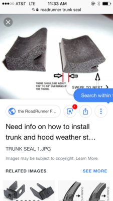

Also this helped me a lot. Make sure to offset the union of ends, so u don't have a leak at the latch.
