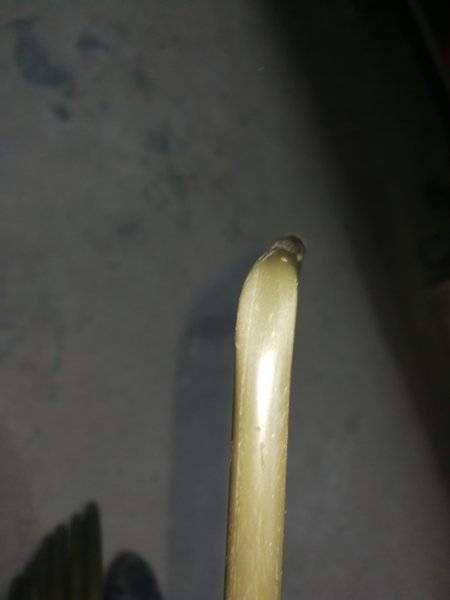

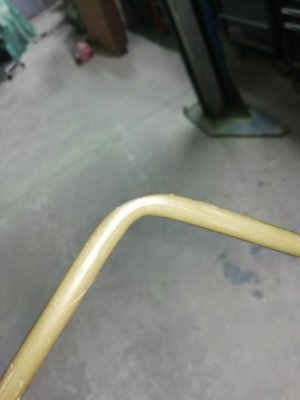

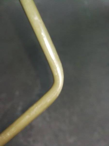

This is 3/8s fuel line. Using the attached tool. The lines kinks every time. Is it normal?

Make sure the tubing fits tight in the groove and be careful and smooth in the bending. If the tubing is fully in the groove for the whole bend and still does that throw it in the trash. The one I use doesn't have the bending handle and fits really tight, nice bends everytime.
I agree if its a custom job. but for OE replacement?

Yea is the main fuel line I am running. I bought the fuel line already. This fuel line is supposed to be easier to bend but it's giving me trouble. The pipe does fit in the bender properly but it's still linking.

I just looked and the tube doesn't fit fullly half way through the bend. I'm bending smoothly.
Ive tried six times.
Can you take a picture of line in the bender set up to make a bend.
