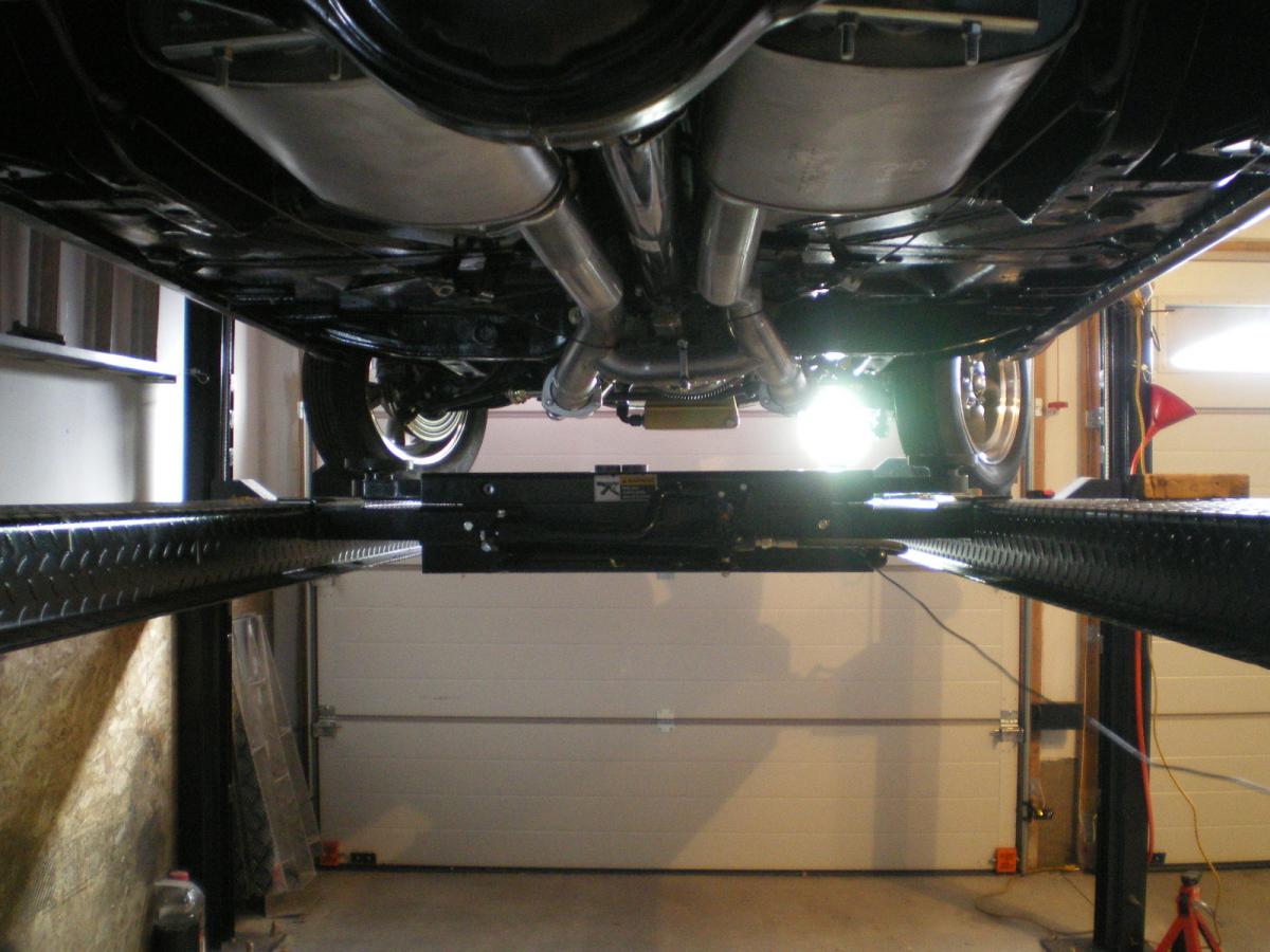

I am using the TTI 2" headers and the 3" system with the X-pipe. I used Dyno-Max Ultra-Flow mufflers and I really like the sound. I also bought mine from Mancini. Ron

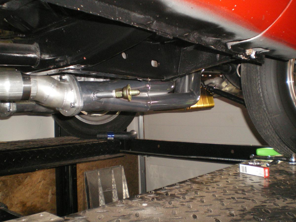

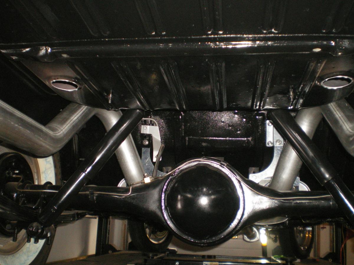

Mike no problem with the park brake cable as it just lays against the pipe but it does not hurt a thing. Ron

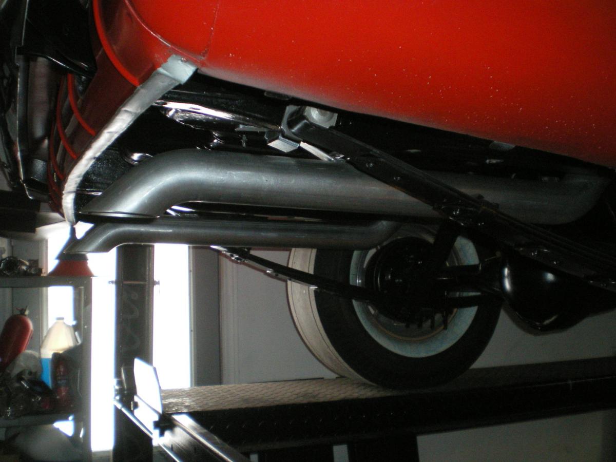

I have the dynomax turbos and they sound mean when you get into the fast petal!
