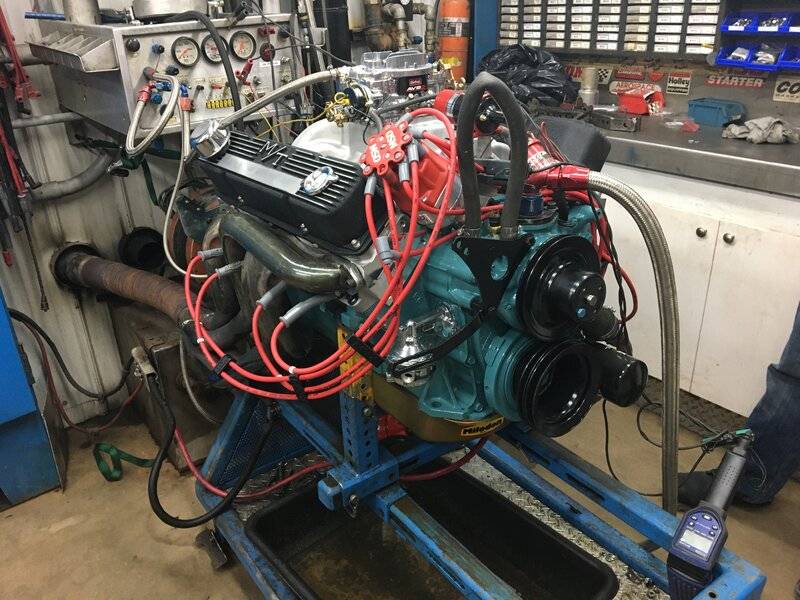

We broke a 440 in a few years ago with Tti headers. The coating got discoloured and a few years later the ceramic coating started coming off. A trip to the blaster and took it to a guy that does ceramic coating and they were like new again. I learned from his experience and took my 440 to the dyno for break in and several pulls, a great way to seat the rings also
. Even got the carb partially adjusted while it was on the stand and set the timing. Was the best $700 I spent. Knew there were no issues before I put in the car and when it was time to fire in the car with my new tti headers not even 2 revolutions and was running perfectly.

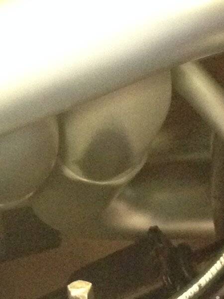

My 360 Challenger uses TTI. Broke it in with the coating. Eventually had them relocoated 15 years later do to surface rust around the flanges. The coating never peeled or bubbled. However the coating from QC coatings in Michigan is much shinier. It also has the aluminized TTI system. Here's a pic 16 years after install with the newer header coating.
