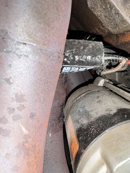

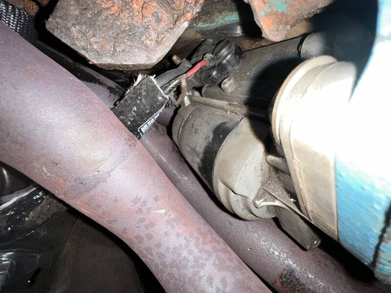

Hey all. I am in the process of doing a 4spd swap to my 65 Satellite (check out my garages for full details) and I just realized that my current starter is pretty tight in the headers. Now this car had the headers on it when I got it with this starter. It was an auto and I didn’t have any issues with starting or heat soak so not sure if I need to worry or not. Here are some pics I took today. The starter is literally touching one of the tubes and the wire is pretty damn close. Here’s a few pics. Am I ok here or should I be looking at another starter? 440 Source has one fairly inexpensive http://store.440source.com/Premium-Light-Weight-High-Torque-Mini-Starter/productinfo/123-1000/

That's my issue, I think. I don't see enough room to even put anything there. The starter housing at the top is actually touching one of the tubes and the wire at the bottom is about an 1/8" from touching the tube. I don't know what I could fit in there, if anything

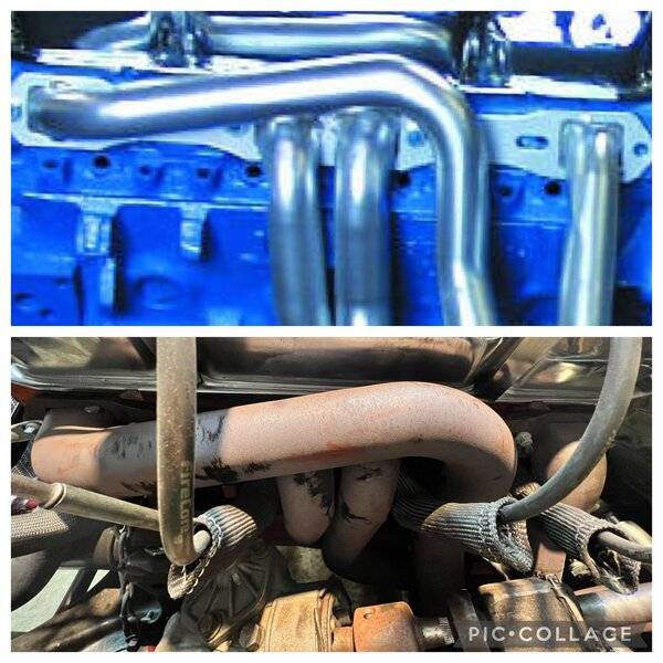

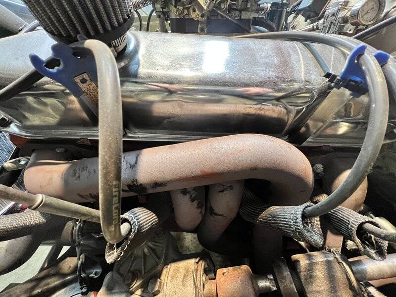

They are TTI. The bare steel, uncoated ones. I’m thinking that what is in here is not a mini starter and that may be my whole issue. Next prob is I think I’ll need to pull the header off to change the starter. Here’s a pic of the TTI headers from their site next to mine for reference.

If not a mini starter then I'm with you. It's always been a issue with headers and starter room. One set of headers fit great another touch the starter. I'll be watching this as you tackle this. But from the pics to me and it just might be the angle of the pic those headers don't look the same.

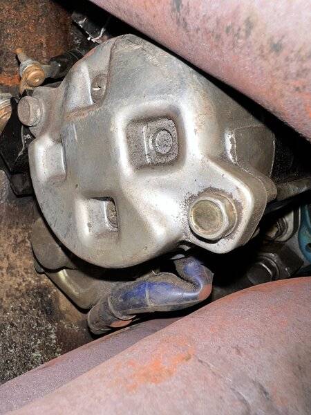

Look at the terminals and outside the case end plate bolts on the OP's starter.
If it's not a mini, then what is it?
@YY1 are you suggesting that you think what is currently installed IS a mini starter? I don't want to spend money to get one if its the same thing
YY1 from the pics I have to agree with you. So now comes to what should be done to get the wiring off the headers. Should he wrap the wiring so not to touch the header. Or use the hammer trick which I myself not a fan of doing.
ok, I saw your comment on the other thread as well. So you also believe this is a mini starter already. I don't want to shell out the cash to buy another one to find out its the same. but either way, it looks like im going to need to pull the header out to make some "adjustments" or wrap the starter or the header pipe right there.

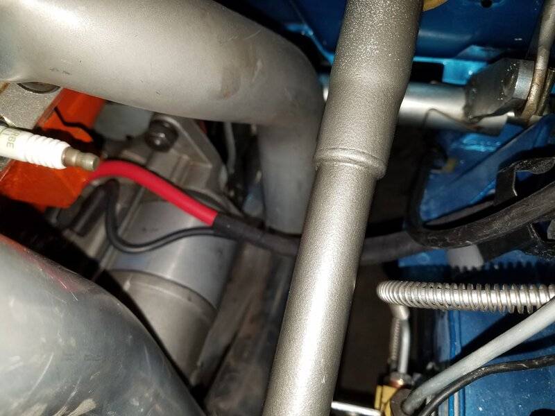

Kind of hard to get a good pic, but here is what I do. I cut the terminal to seperate the 2 wires so I can route them easier. This starter is from DB Electrical. There is at least 3/4" from the front of it to the header tube.

Yes after seeing what YY1 has pics of it looks to be a mini. I think if you step back and just redo the wiring so not to lay on the header you will be fine.
