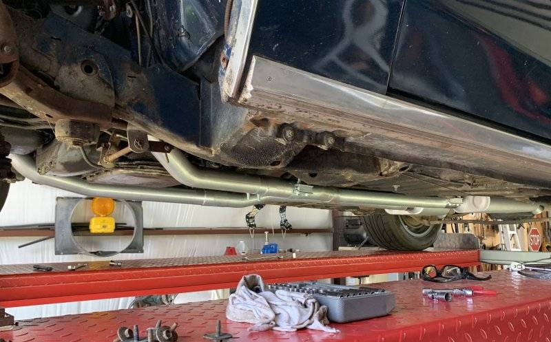

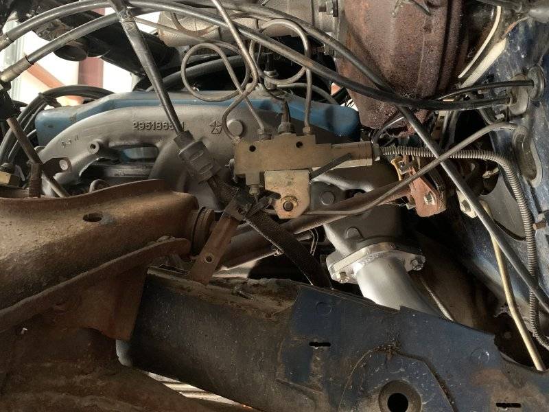

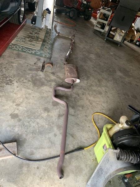

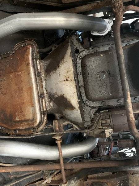

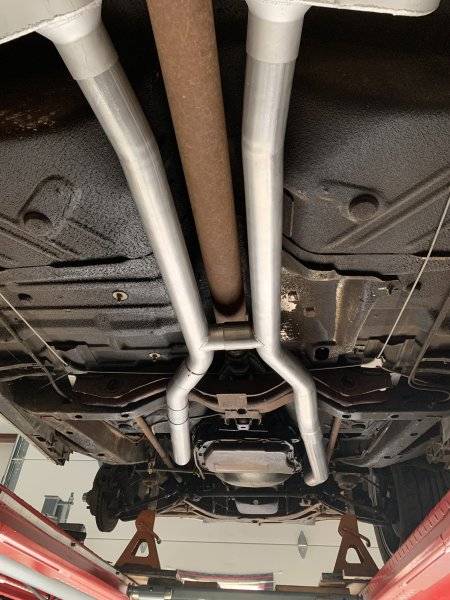

Well I have to say I am extremely impressed and very pleased with these pipes and the complete set up. I took a chance with the HP manifolds not knowing for certain if they would work on this car and then had TTI make some pipes to fit a car that didn't come with these manifolds. In the end I am going to end up with a fantastic exhaust system that I would have never have guessed would fit on this car.
The TTI head pipes and H-pipe were not perfect but damn close. I am extremely happy how the head pipes turned out and find it hard to believe that they can make these pipes fit so well as complicated as they are. The drivers side head pipe is a work of art! I had to cut out and modify a section of the drivers side H-pipe but that didn't hurt my feeling any considering how nice the rest fit.

I am pretty much done for now. I might put on some tail pipes later if and when I get the smaller gas tank.
