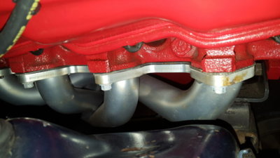

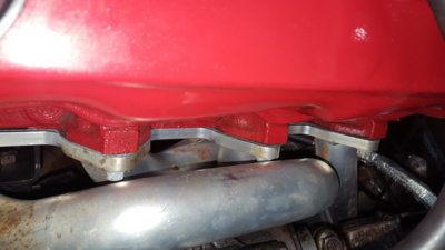

Bought/installed in July 2018, showing rust 5 months later. Rust on the tubes, not even in the joints.
2 year warranty on coating, have to pack up and pay shipping there and back.
TTI doesn't even coat their own headers.
No guarantees Engineered Applications will re-coat them.
I won't be removing and sending back.
Not pleased.

Rusting on the tubes. there's no excuse....thats poor prep from the vendor.....
I didn't know they used an outside source to coat them......
I didn't realize it either, never saw info on who coated them, never thought to look.

I wouldnt even waste my time sending them in, Polish it up with some never dull you’d be surprised how much rust it will take off.
10 year old polished ceramic here. Outside, but easy life in mild climate. Some rust early on, but they are still intact. Slammmed and ground in a number of high speed compression hits.
Not a show car, so I will buy them again for weight savings, coating to keep cool, and ease of fit. Expensive yes.
Ceramic coated, polished TTi headers. South Louisiana swamps 3 years+. No visible rust. Occasionally drive my car, maybe 2,000 miles or less/yr.
