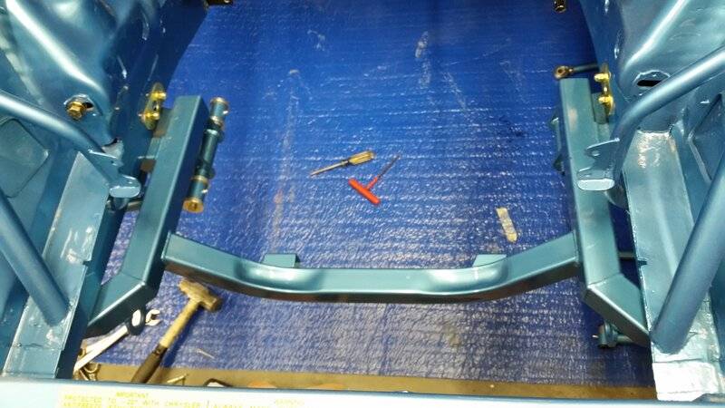

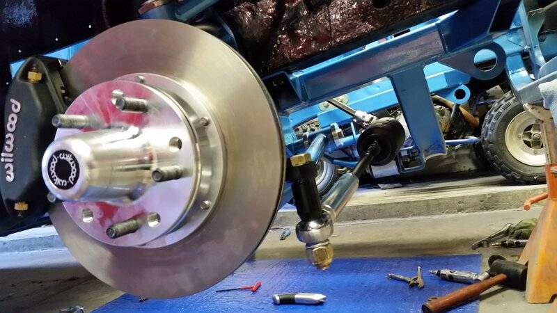

I have a RMS tubular K Frame, tubular upper and lower control arms with coil overs and a manual rack that I drive on the street with no complaints. I can install and remove both side headers with engine installed. I am able to run a 10 quart flat bottom oil pan and it doesn't even hang as low as my headers.
