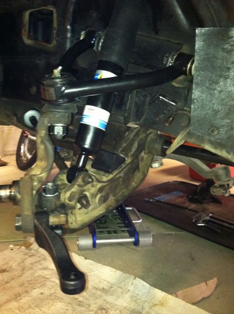

I just had a good experience with the Firm Feel UCA's. I did a whole Firm Feel front end. Afterward I took the car (70 RR) to an alignment shop with one of the fancy digital alignment computers that hang a computer sensor on each wheel. I gave them both the factory specs and the ones Firm Feel had given me. I decided to go with the Firm Feel Specs based on their advice and the alignment shop's.
I watched as they dialed in all of the specs, including the 4 degrees of positive caster, to within one tenth of one degree - right there on the screen. Amazing machinery.
And the car drives great. I started driving it around like a corvette until I remembered that it was me who had installed all of the parts. I'm gonna take it easy for a while and see if anything I installed falls off...
