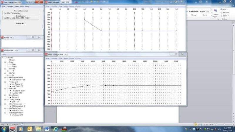

Hi
Ive been running a dual quad 6.1 with the MSD box for 8 years.
I’d like to examine your timing curves, both RPM and MAP.
I have a suspicion your MAP curve is not set up correctly and is pulling timing from your RPM curve.
I’ve added a pic of my timing curve - note there is nothing below the 0deg mark.
