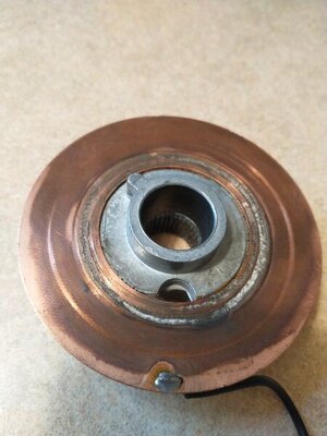

Here’s a pic to help you to know what to look for trust me there’s a good chance this is the problem. In the pic you’ll see the gray insulator that insulates the copper contact plate from the steel wheel hub which is ground. The horn relay has positive on it at all times the horn switch completes the circuit by connecting the other side of the horn relay coil to ground.
