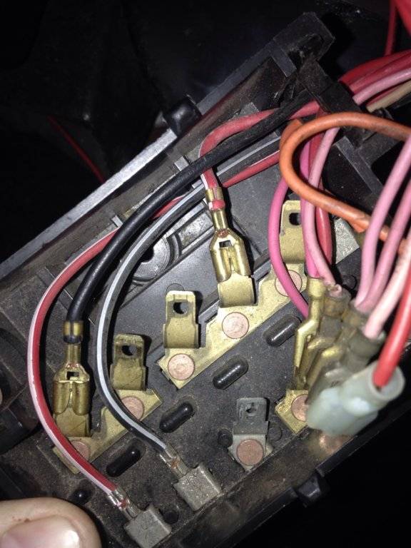

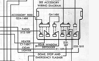

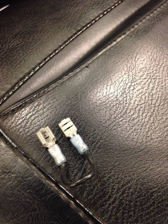

Car-0 Me-1..... I figured it out! After chasing wires and going rounds with my knuckles under the dash I figured it out. I chased power back to the fuse box an found my issue. The first two fuse holders (radio, backup & heat A/C) are keyed Acc power. The next is the rear defogger and acc of which my car doesn't have neither. The Buss bar for that 3rd fuse slot should be separate on the one side but its not. It is connected to the 4th and 5th fuses in my fuse holder via the buss bar. That 4th one is 12V hot for the Dome/Cigar Lighter. They had a jumper on the third one to the second one like factory but the buss bar was hot so it was feeding my heat and radio circuits 12V of power live all the time. See the pics to show what was different on my fuse holder. Maybe a repop? not sure why it'd be different from the Diagram but hey it's fixed!!! Yatzee that is what I was thinking and that is why I sniffed by the fuse holder. Thanks again for the extra ideas! Always good to bounce ideas off a few and reassure your on the right track!
