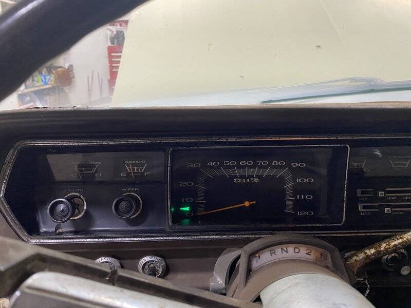

I recently bought a 67 Belvedere wagon and I’m having two issues. When the headlights are on the left turn signal indicator is always illuminated. It will blink if using the turn signal or flashers and all the the lights outside are operating properly. The second thing is the gas gauge only works if the headlights are on. It has a new gas tank and sending unit. Any ideas?
I recently bought a 67 Belvedere wagon and I’m having two issues. When the headlights are on the left turn signal indicator is always illuminated. It will blink if using the turn signal or flashers and all the the lights outside are operating properly. The second thing is the gas gauge only works if the headlights are on. It has a new gas tank and sending unit. Any ideas? View attachment 1159356

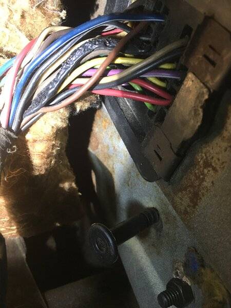

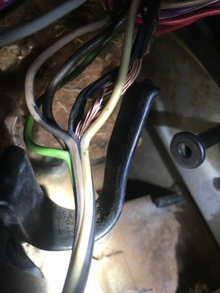

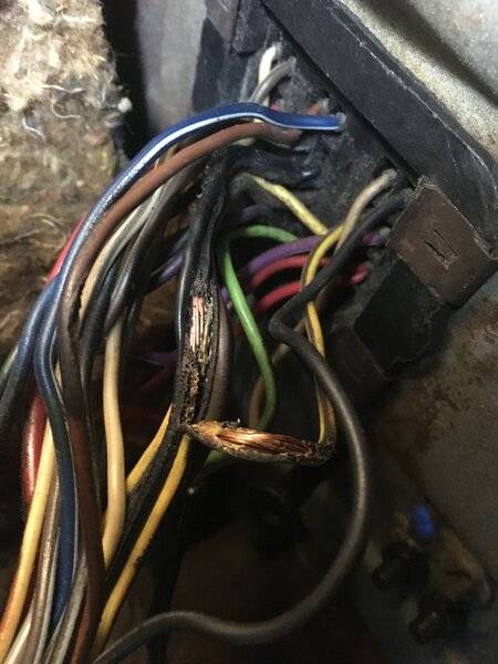

AR67GTX just nailed it. So for years I've had various electrical gremlins that came and went (like a lot of us here) some I found, some just vanished but a few remain like my aftermarket tach randomly spiking, car totally shutting off, ignition not firing with key. I have been through bulkhead connector many times and fixes something but will return or morph into something else eventually. Last night I'm driving from VA Beach to Outter Banks for a much needed week off with family and the right turn signal lights up steady, than alternator shits, voltage regulator burnt(found that after alternator change) and when I stopped (car shut off) to check things out the the right front marker light is on! I manage to get car home on battery power, let's get to the point, this is what I found under dash, power wire got so hot it fused four wires to one big mess and wires touched. After many hours of careful splicing and tapping this car has never run so good......not one issue, key is working, tach not spiking, it's frick'n awesome. Lesson learned, pay extreme attention to cleaning and tighten each pin, I wish I spent more time doing so.
