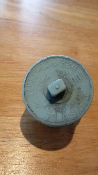

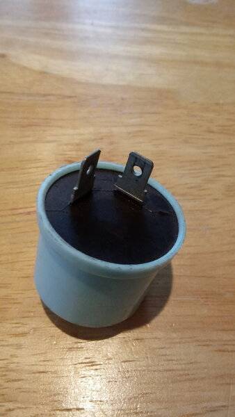

Mystery solved! Gave the socket a shot of WD-40 this am but still no improvement. When I had all of the flashers on noticed that the drivers side side flashed quicker than the passenger side. Also could hear the flasher click differently fast, slow, fast, slow.
Pulled the flasher out & then re-inserted. Now everything now worked as it should. Turns out there was some slight corrosion on the flasher tabs. So cleaned them up with my dermal wire brush to make them all shiny again.
Looks to be original flasher unit. Thanks everyone for your help!
Original flashers are/were metallic. Thats a later replacement. But works the same just being a plastic housing and no need for the bracket, since the stud would fit in place of the bracket.
