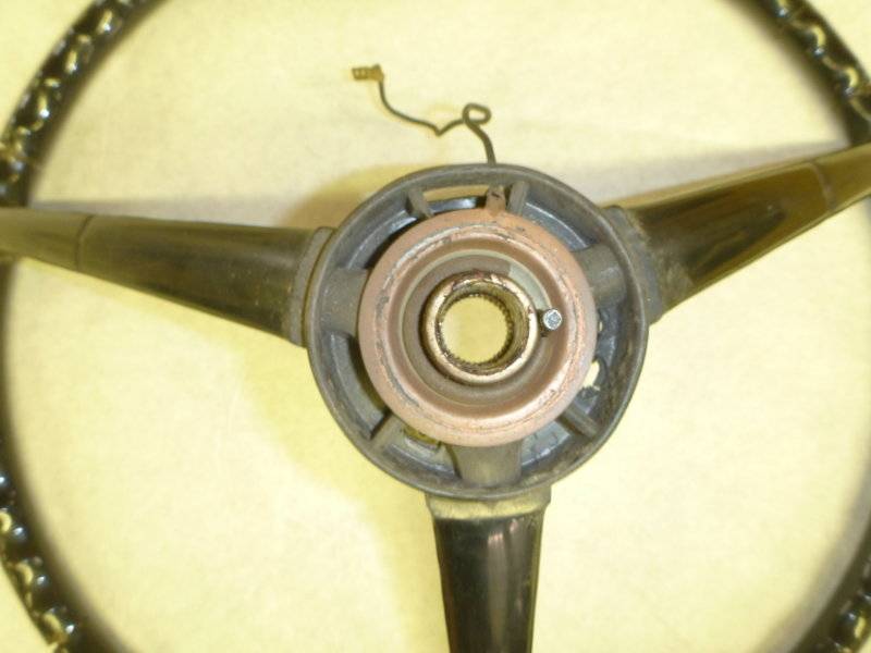

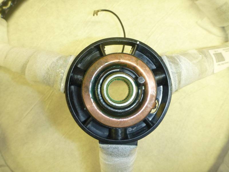

Just thinking here, but is the actuator on the steering wheel centered in the switch
The heavy curly cue wire approximately 1/4" in diameter.
My OE (top) and the way a replacement was received (bottom), requiring the wire to be smacked a few times into center.

That would only affect whether the self cancel feature would work or not. The turn signal can not be manually canceled even with the steering wheel off the column.
