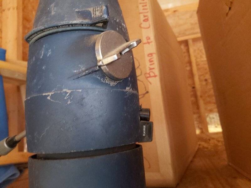

Thanks everyone, the one on my car now only cancels for the left signal. I have to change the ignition switch so I was thinking of changing the turn signal at the same time. I have a spare here but don't know its condition as its in a column. Thanks for tips Wayne. Nacho did I did not know there were two different ones so must be two part numbers. I will check my book. QuickBpBp your message box is full.

if is juts a problem about the cancelling system, replacements are avaliable for the canceling cam. It must have got the canceling tab for that side

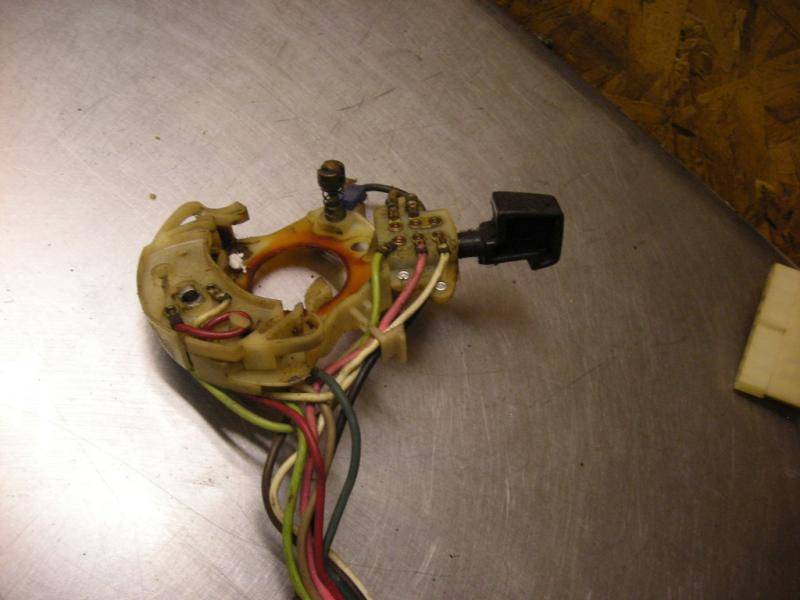

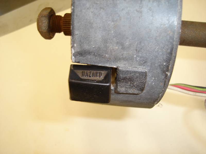

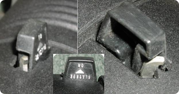

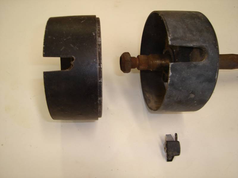

and yes... there is differences since half of the 71 production. This makes a diff collar and ignition light courtesy setup. Of course they are diff PN, but the earliers is virtually imposible to find ( on a decent price at least ).
this is the earlier:
collar and courtesy light with that knob
with another difference between E and B body

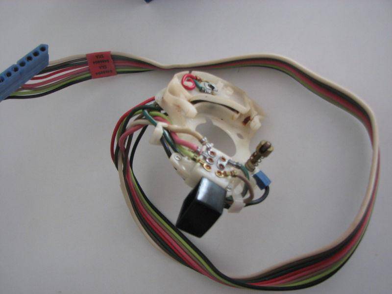

this is the later ( all pull out to turn on )
Collars difference side by side

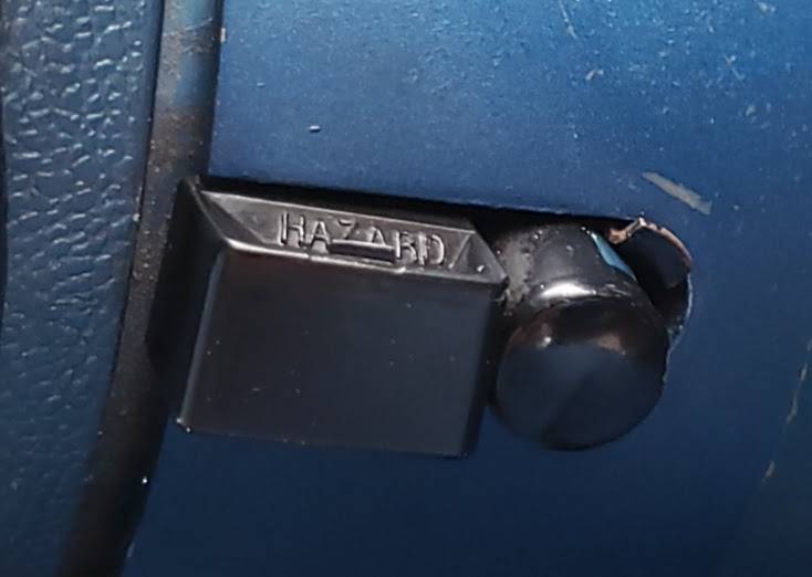

here, lates assembly with the ign courtsey light. Knob is noticeable thicker, and courtesy light totally diff.
How it looks when no cortesy light plug filler is included which is visible on a previous pic

Thanks Nacho, I had to go look I do not have the light. I will check my spare later as its up on a shelve. I mabe able to just use the cam off it.

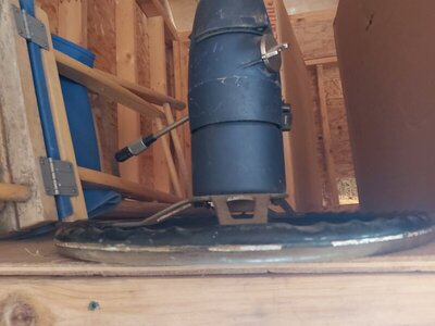

Well the one on my car has no light and the spare does. Do the cams inter change?

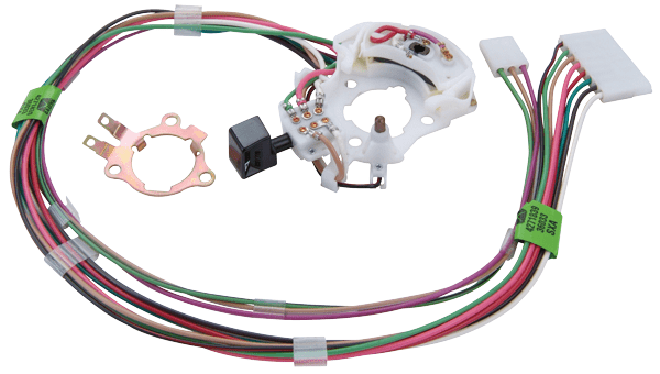

I'm confident it's not generic. I bought it from a reputable seller. It has the Chrysler logo in the plastic and all the correct colored wires. Also has some age to it, but has not been used. And, doesn't have that bright yellow cam that so many of the aftermarket have!
Roller tip for horn ? Or plain stud? I know MP made some new replacements quite ago which included the cornering light feature, and these are with a plain brass stud like the replacements instead the roller tip for the horn ring down the PN 4293102.
I guess it was made somehow generic replacement for all models then you will or will not use the cornering light harness. I can also see a weird and diff holding bracket with prongs on pic. I guess some laters needed some ground provision?
The original PN for this with the cornering light feature was 3488805, while without the cornering light feature is 3488804, both with roller tip of course. Can't recall PNs for 70/71s ( earliers 71s )
Cams interchange. Switch is the same all around but just the knob shape between earliers and laters. However I think you are not really understanding the deal.
The spare you posted gets the light and is visibly a laters one.

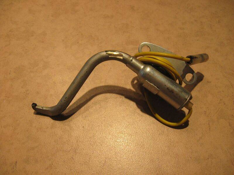

The earliers also can get the light just is a diff design for light and knob. On the pic I posted, the small silver piece down the knob for the hazzard is the light. Which is this:
However the full laters assembly could fit on earliers easily just trimming out the knob if interferes with the collar &/or light if equipped.
