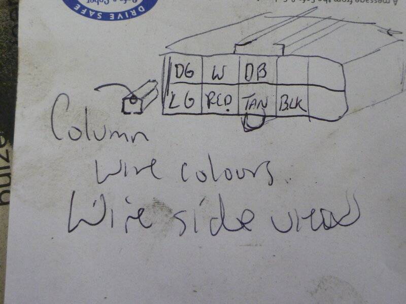

Sounds like a wire is crossed in the new turn signal switch? The new switches have a couple of wires colored different than the originals. Got to make sure you get them in the right spot in the connector.
