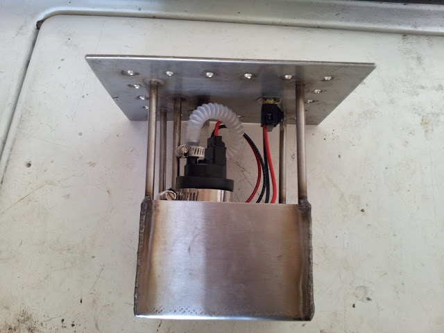

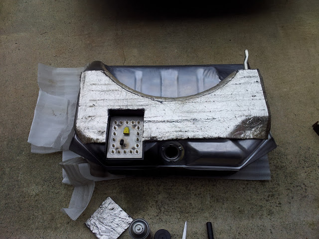

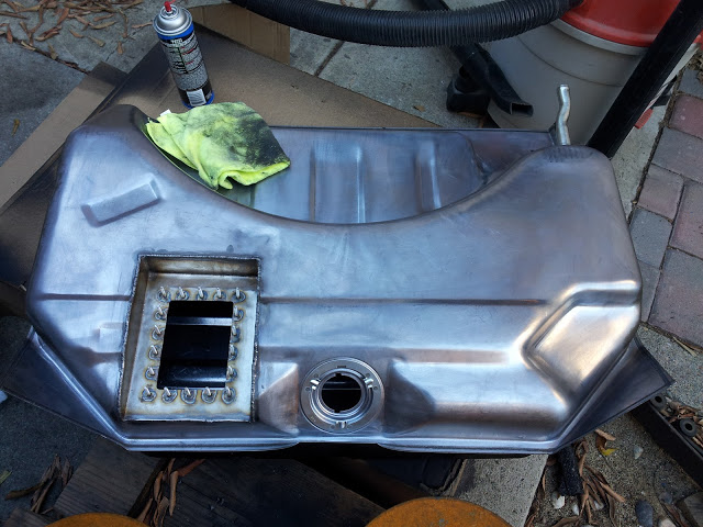

I ended up using a Walbro high pressure pump (90 psi and 250 lph) in a small sump that Meep-meep and I made. We cut a recess in the top of a new tank, welded in a tray, and suspended the pump. So far, the set up is in the car, but it is not wired up and pumping yet.
Here's the modified tank:
Here's the sump, although we added more baffles to the top half after this:
I'll get a picture of the whole setup later. It seems to have never made it off the phone... For now- I'm pretty happy with how it worked out. The '68 tank should be a bit easier to modify.

My tank is just a Spectra unit. Nice tank. Cheap enough. I figure I have $400 into my setup, not including time (mine or anyone else's). $900 isn't bad if you're looking for a turn-key setup. And if they are building the tank from scratch, they can put much better baffling inside the tank- probably a better option. But then again, it's over twice the cost. We did that setup up at the missile base, and it wasn't super easy. The '68 tanks should be easier, and we know more now. I guess it depends on what's important to you- time, money, turn-key, or some combination.

Here's a picture of my final tank. So far, no leaks... Hoping to hook up the fuel pump soon.
